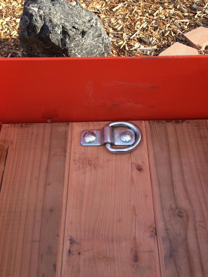

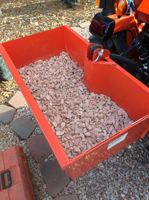

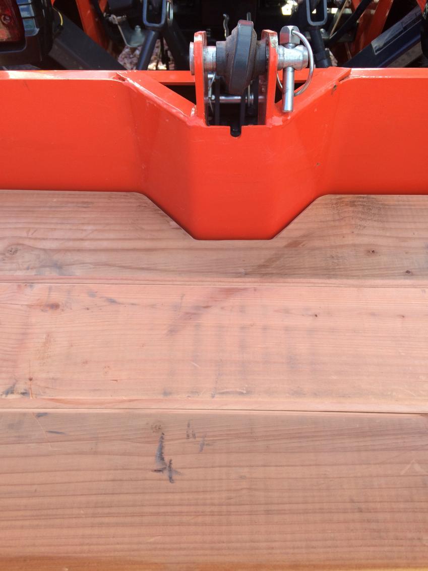

Since the tires are filled with RimGuard on my new Kubota B2620 I elected to use a little bit of the space on the top of the weight box as a storage area. After filling about 3/4 of the weight box with 3/4" - 1" stone I made a custom fitting deck to lay tools, a lunch box, cooler or anything else requiring storage space. I used a couple D-rings for easy removal since the 4 sides are slightly tapered and the top is sure to get wedged in there. Simple and easy made from some left over 2x6 redwood stock I had kicking around.

how is the wood "nailed" down ? Crossmember laying on the stone?

This is simply 3 boards clamped together and then on the back side I used 1/4" x 3" wide plywood strips as screw cleats; no glue at all. :):)

...and yes, it just lays in the weight box; I didn't want anything permanent.
