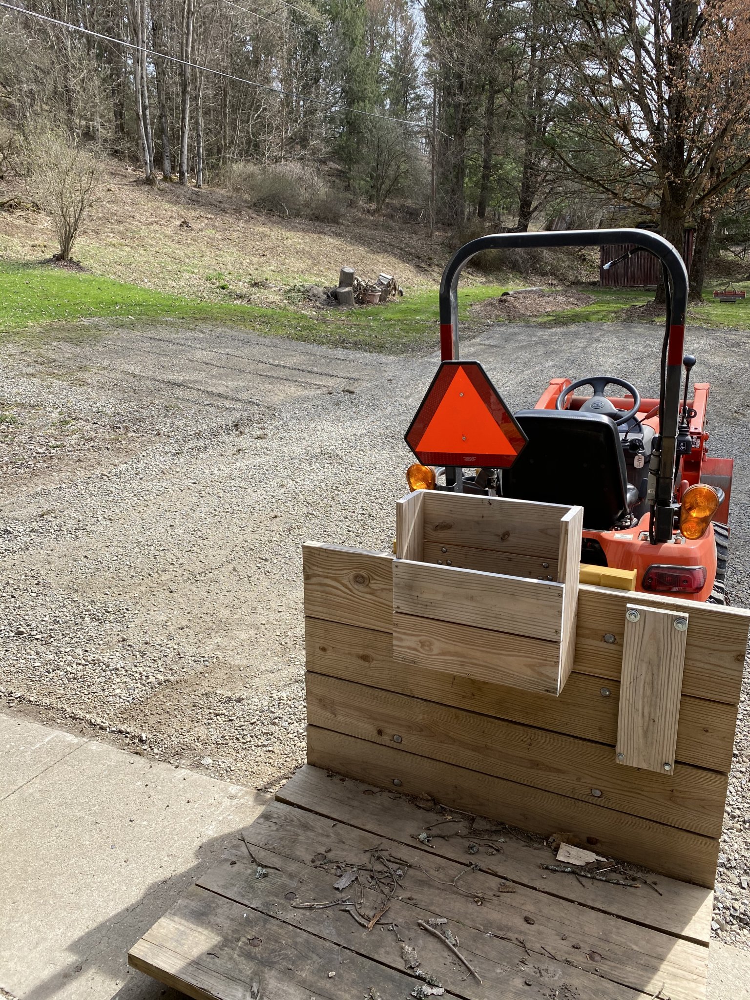

...I have 3pt pallet forks and a homemade carry all...
Cheap works... no need to to buy a ballast box. I built my "forks" to be used for several things, sprayer, carry-all, and a ballast 'drum'. I do have a dedicated pallet forks for my pallets of firewood.

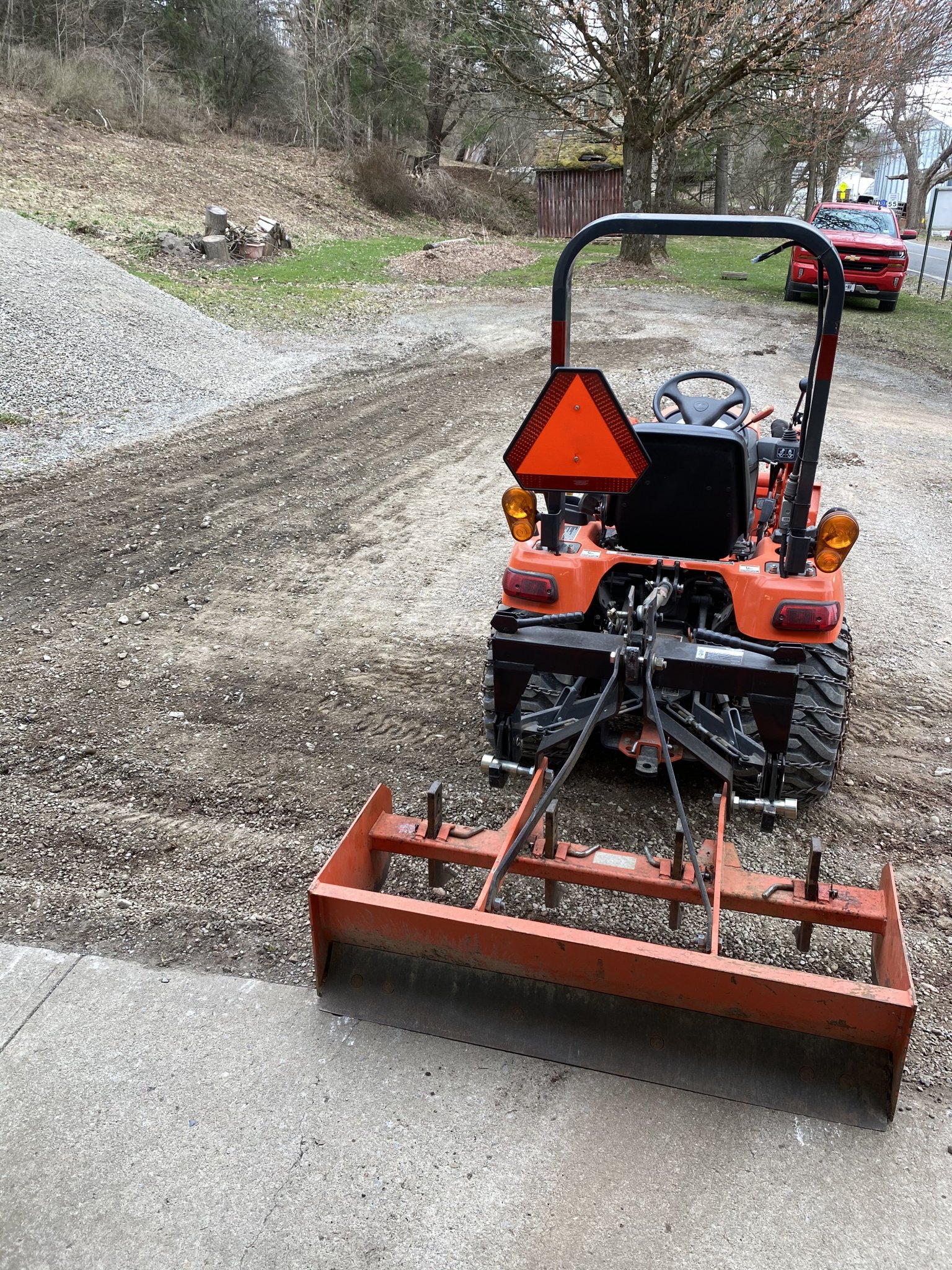

If your carryall turns out to be too bulky, I would change it out later. Try it first! I do use a box blade as ballast at times, better than just a Box.

My opinion, but in open ground with both a carry-all and 5’ box blade, you’re all set!! ;) :cool:
8,421
4,074
Of course, I’m not impartial…..never saw a need for another implement. It is true that a ballast box can be more compact, but I can accommodate.

Nice job RCW !
One big advantage to a carryall like you show is it moves the ballast weight further behind the rear axle. Its like a multiplying effect on the actual weight you have on it. ie if a ballast box has 600lbs of weight centered 30" behind the axle you would only need 400lbs centered 40" behind the axle. If you put 600 on your carryall a ballast box would need 900 for the same effect.
The distances I used are just for illustration but I think I get my point across.

I am getting a lot of votes to use what I got. I am pretty sure I am going to practice with my carry all or box blade. Nice job on your carry all.

Robert - - like ctfjr said, the carry-all moves weight back aways.
I figure the carry-all weighs about 200 pounds +/-.
Without the loader on, I had almost 400 pounds on the carry-all couple summers ago. Was wet bags of topsoil and wet mulch.
Front tires were pointing skyward......being stubborn, I got stuff moved where I wanted. Kept wishing for individual wheel brakes.
It does demonstrate ctfjr's point. Wouldn't have been an issue if the loader were on.

I built this carry all from a King Kutter frame about a month ago for my B2601. Plans at DIY My Way. It has already been used for spraying, hauling seed, fertilizer etc and carrying weedeaters and other tools around my place to do work. Side panels fold in. I still need to build the removable tail gate from a couple of 2x10's. Very useful for multiple purposes!

Does this mean that when using the box blade I will need the front end loader to be attached?
Not necessarily. My BB is not overly heavy, and I can use it without the FEl. Front (4WD) traction is compromised some without the FEL's weight, but it's still very much usable. Maybe just can't do real heavy ground-engaging.
If it were an issue, you could add front suitcase weights. However, I'd still hold that in abeyance until you see how it works first-hand.....kinda the same philosophy as not really needing one more implement....
