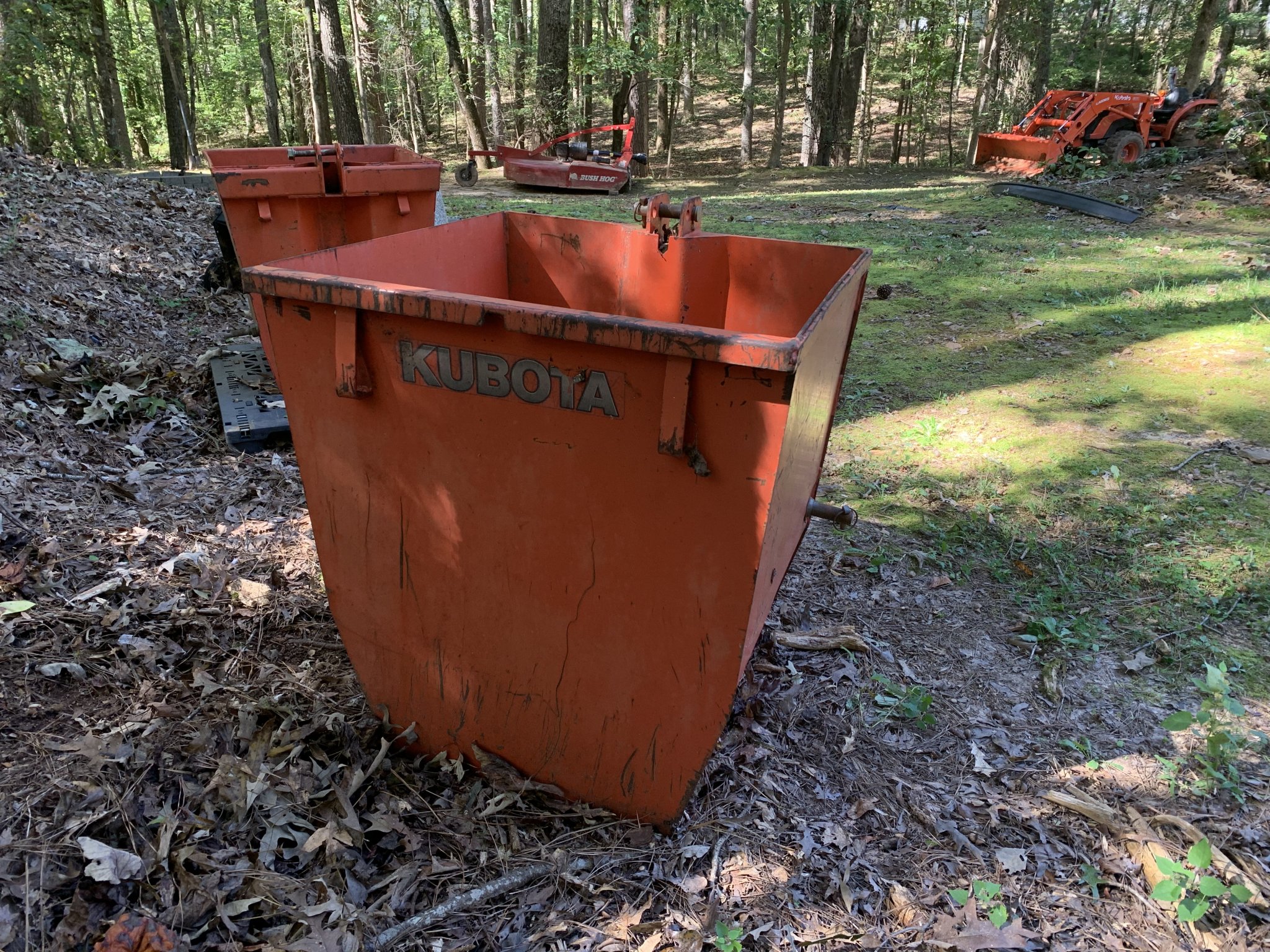

My 4 in 1 weighs close to 700lbs. Kubota light duty bucket weighs around half that. My grapple weighs about 500lbs.

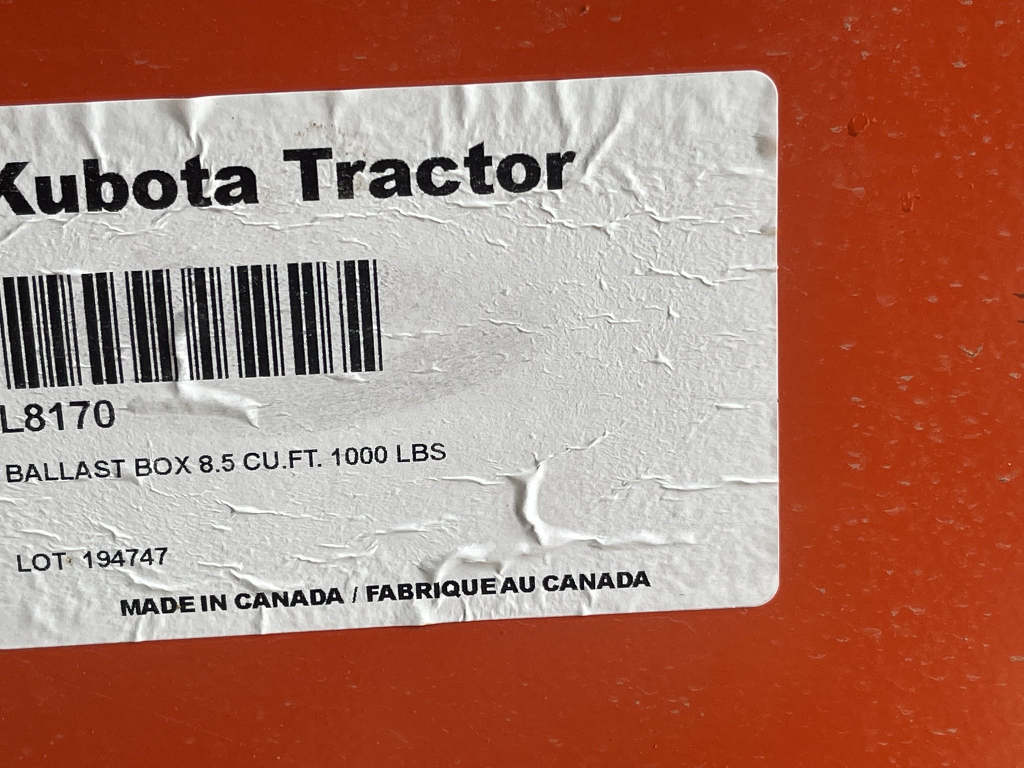

On my 4760 I have filled rear tires and according to the chart at Messicks it adds 357.5lbs of ballast per tire that is water/methanol mix. If you add Rim Guard to the tires the added ballast adds up to 589lbs. per tire. Tires loaded works fine for light duty standard bucket work hauling mulch, spreading gravel, it also does light duty grapple work. When I do heavier work or put on the 4in1 I add the weight box. It is a Kubota class 1/2 and filled with gravel is close to 1,000lbs (see photos) I also have my tires set at the widest position. The tractor is very stable when using the heavy buckets.
I have what I believe is an M8180. Dimensions are 28.5x28x31. Cat1/2 pins.
