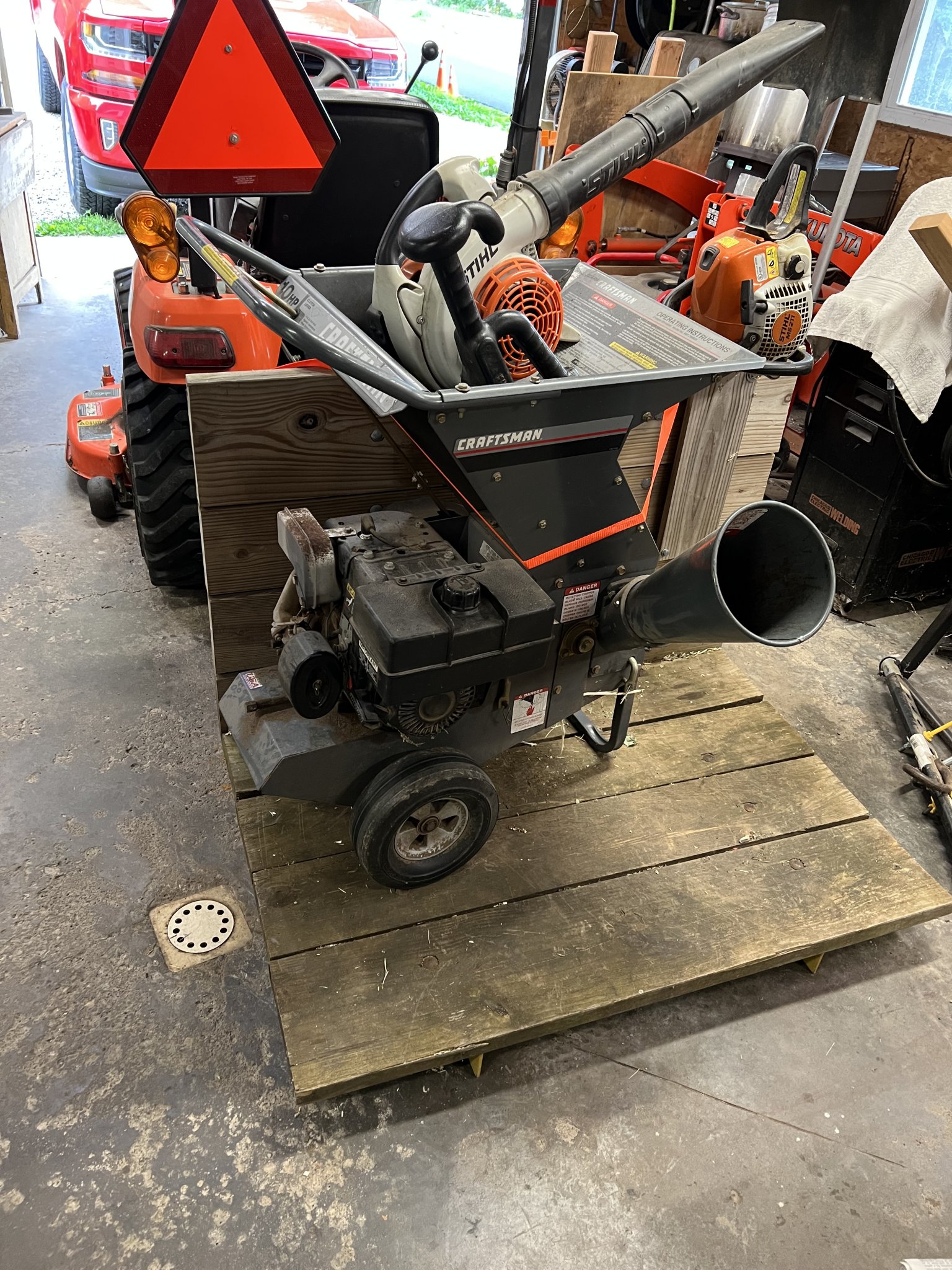

Mark mentioned a carry all.
This is mine set up for brush cutting and chipping.
Anything can be added for shear weight, but as D2Cat mentioned, they take up more space, which can be a problem in tight quarters.
