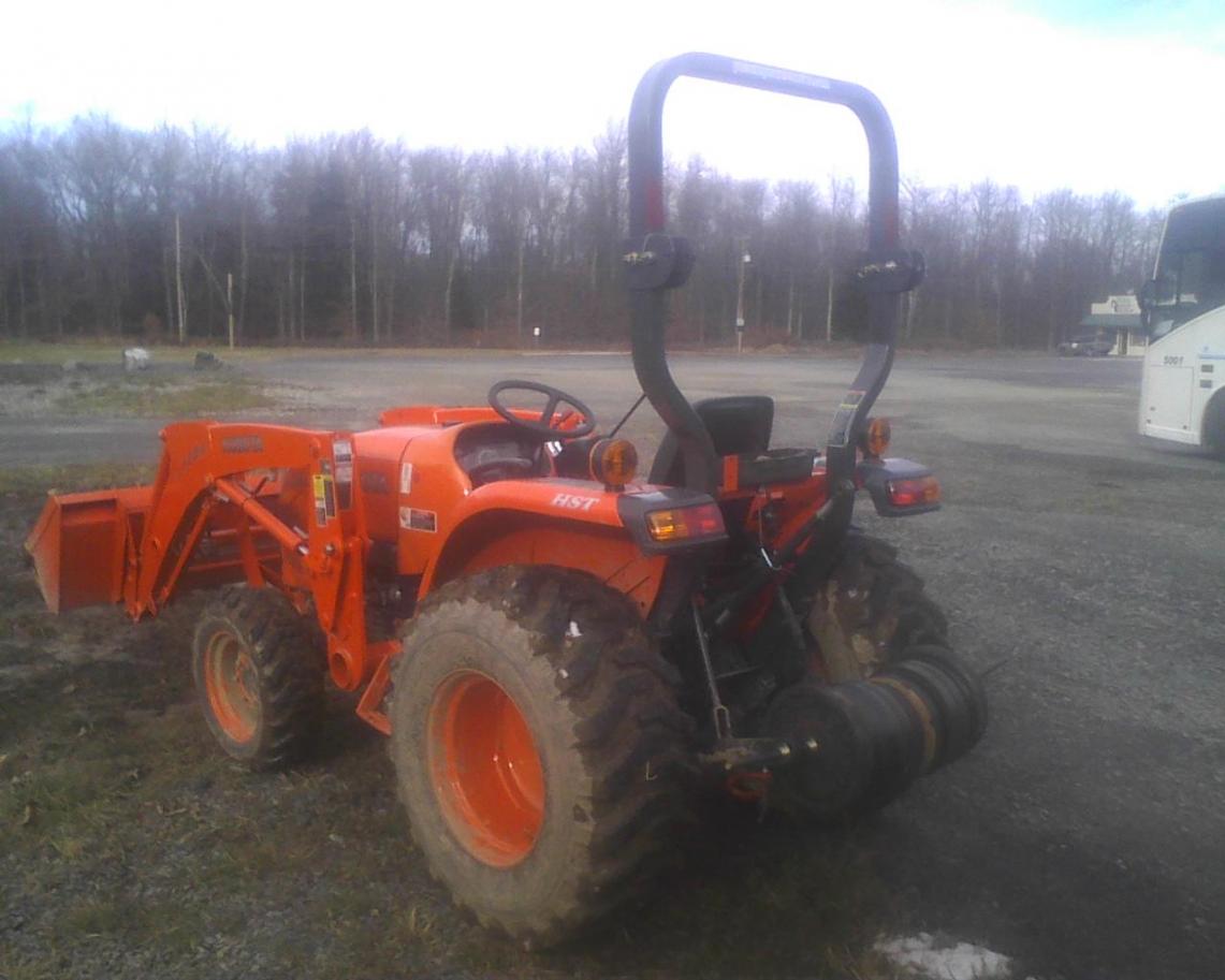

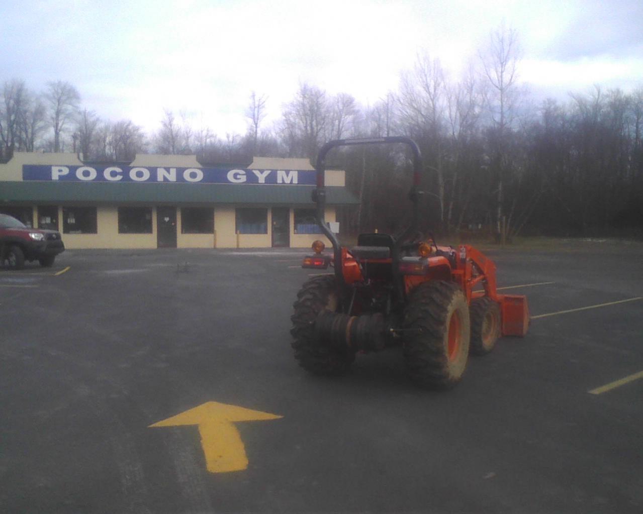

tsafa
Kubota L3800, FEL, F550 Dump, 10K Trailer
Nov 3, 2013
152
Tobyhanna, PA
I was a lot easier and cheaper for me to run a 3/4 inch bar through through the 3 point and load 500 lbs of barbell plates there. Since taking the picture I have rearranged the weights so they are spread more evenly across the bar.
The tires are loaded too on my L3800. The tractor handles very well when moving around... however.... when doing heavy loader work I think I need to add another 200 to 400 lbs back there.
I did about 25 hrs of work with the FEL and I realized I had to stay in 4x4 mode because I was loosing traction in the back as the weight was shifting forward. This was also stressing the front axle. Now if can run in 2x4 unless I am working in mud.
