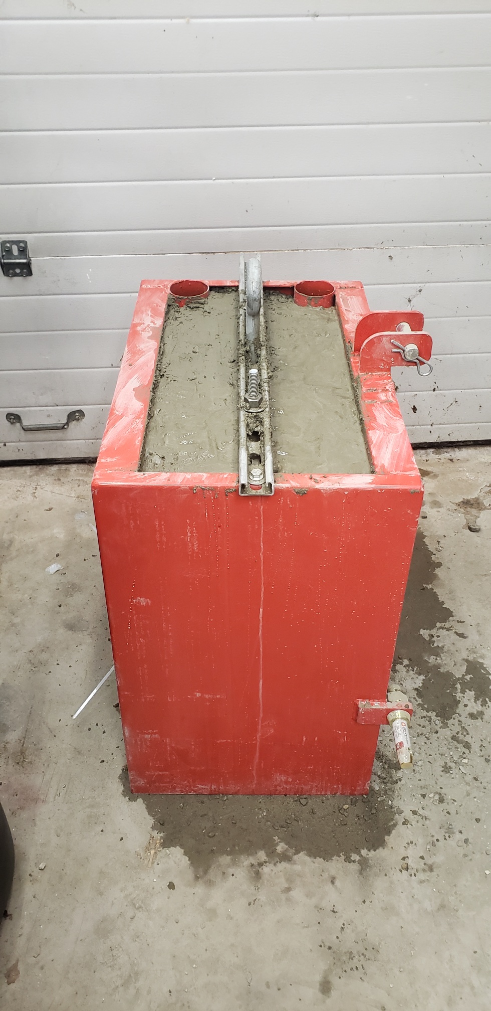

I made a frame that I dropped in it with a lifting lug and a couple of 1/2" threaded rods. The lifting lug came in handy - as another poster mentioned, I too had an issue hooking up because the lower pins were too low. Just lifted it with the lug and dropped it on a skid.
Then I filled it with concrete

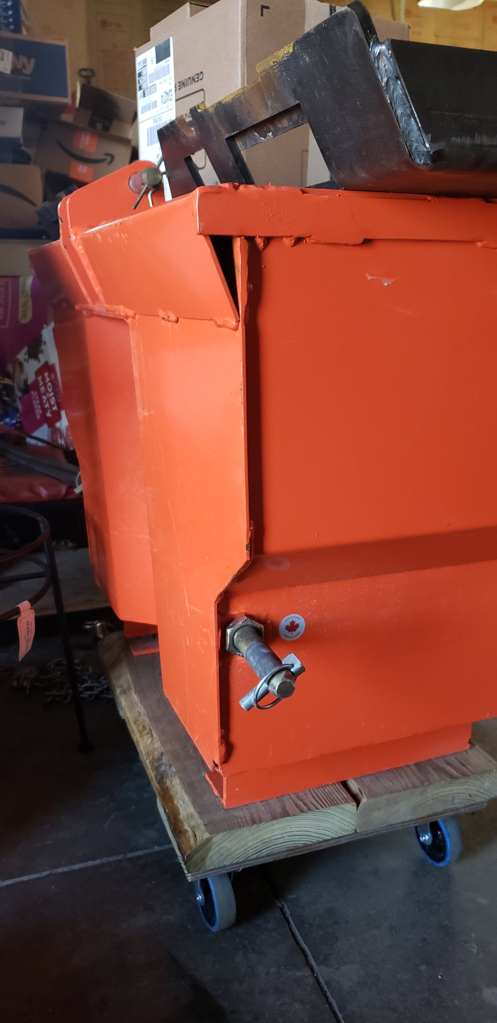

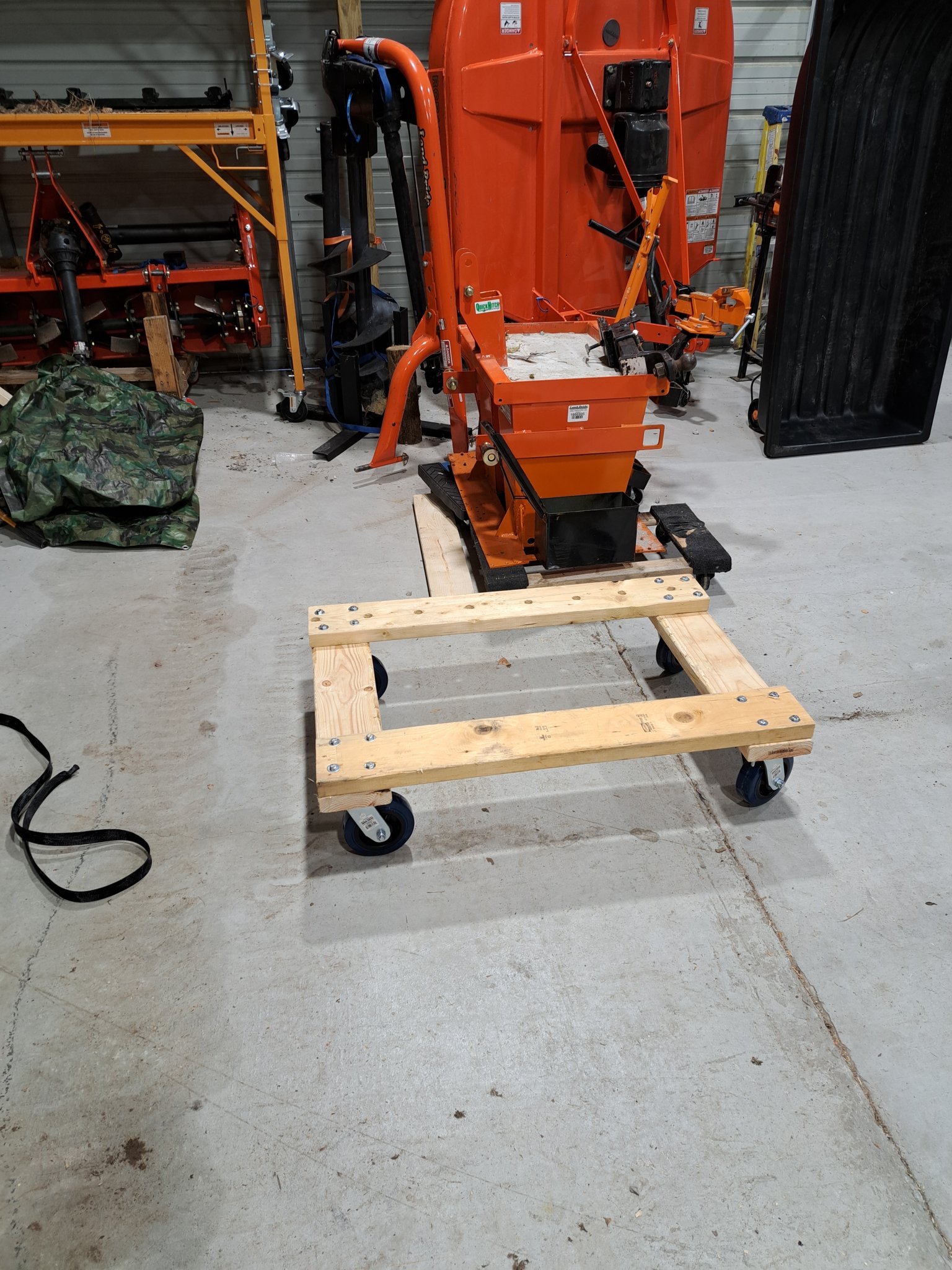

Although the OP hasn't been seen in 3 years I thought this may be useful to others our age. I made a cheap dolly out of scrap lumber. It raises the box enough to be easily hooked up and allows me to push it around when storing (with great effort depending on how mush weight I have in it). Just make sure the wheels are rated for the weight you have, I'm on my second set having flattened the first set.
I got the box with the tractor and would NOT have if I realized it is not QH compatible. But I'm a semi-newbe and moderately uneducated to all things tractor. In the process of adding flat stock to move the lower pins forward so the QH will fit. Will likely have to fiddle with the top link also.

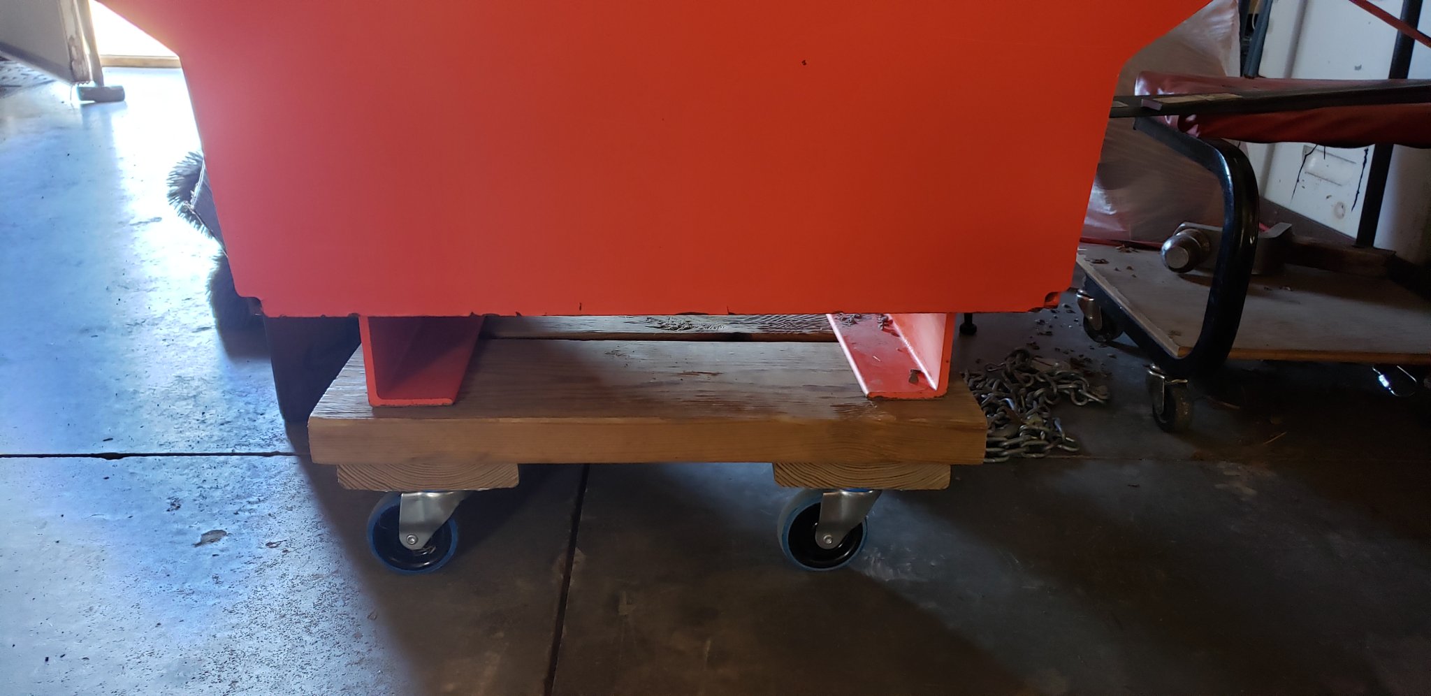

Since I break out the welder for just about any reason I can, I welded a frame around the bottom of mine and attached a sweet set of casters.
I then proceeded to set the worlds record for........'How fast can a guy break off a set of casters?"
I think I am still the reigning champion at 58.087 seconds.
The "up side" is that this that the base I welded up fits this dolly like a glove.

Did you weld the Quick Hitch top link bracket to your Land Pride Box? I think I'll have to do something like that to get the top to line up with the lower pins once I move them.
No, it came like that.
I bought it as a package with the tractor.
In hindsight, I would not have bought one at all, and just put that money towards my backhoe which stays on the vast majority of the time. (like ~99.989% of the time)
Although I did have fun modifying it, so theres some satisfaction/entertainment/fun factor to add into the equation.
