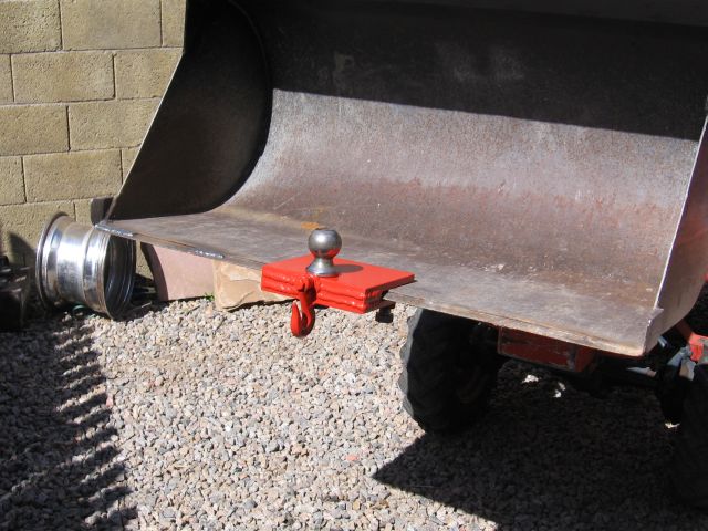

Using the loader bucket may be the best answer. By pushing trailer in front,you can run trailer exactly where you want,without having to look backwards.
7,754
2,898
Agreed, here's what I made:
ShaunRH
L3200
May 14, 2014
1,414
Atascadero, CA
Nice...
My father just torched a hole in the front bucket of what is now my D-17 and tosses a ball on there when he wants. I like your quick attach better!
