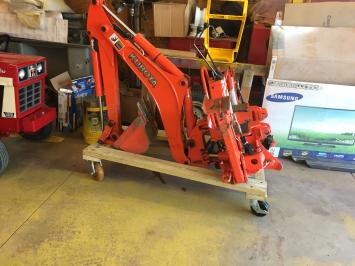

Get a couple inexpensive Harbor Freight furniture Dolly***8217;s and a piece of plywood and make a low raised rolling stand. Once the BH is on the stand, lift the legs and tie them together so they do not go down over time. It***8217;s easy to roll around when you remove it.

A dolly is the way to go. I also made a dolly out of plywood and caster very similar to the same shape as the BXpanded steel dolly. Works just fine and I tie the two stabilizers together so they don't drift down. Easy to roll the whole thing out of the way if you have a decent floor.
