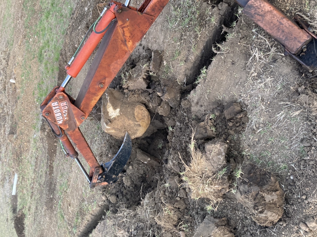

What is the pin diameter and center to center spacing of the holes on the backhoe bucket? It may take bx stuff and northern tool towable hoe attachments (which i discovered are interchangeable).
I have a $160 ripper tooth from Northern for my 4520 and for the money im thrilled with it. 🤷‍♂️

Yes the ripper is $160. It only has to be strong enough for a small machine but i have yet to damage it.
The observation about mini ex’s using metric vs our backhoes standard pins is a good one. I bought a cheap chinese mini ex bucket made for 30mm pins and welded 1” shaft collars to it to use it on this backhoe. The holes were spaced closer together though so i did lose some ‘breakout’ force, but not enough to make me switch back. My hoe only came with a 16” bucket and i wanted something smaller but still cheap. I paid $200 for the bucket and maybe $10 for 4 shaft collars to weld to it.
