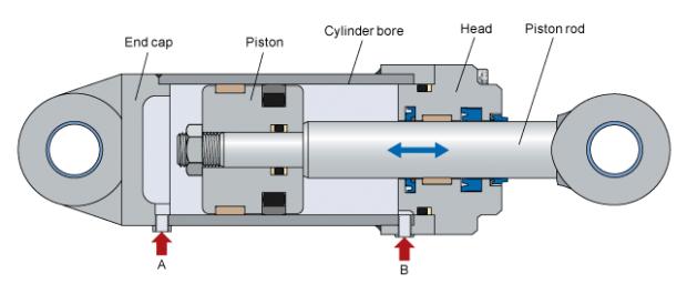

When back dragging under load, you can catch the bucket on a rock or root, breaking the threaded end of the ram off inside the cylinder. (see generic pic below)
This series is slightly more susceptible to this because of the single ram, where most others have two to spread the shock load. A teardown is called for, but I'll bet that's your problem.

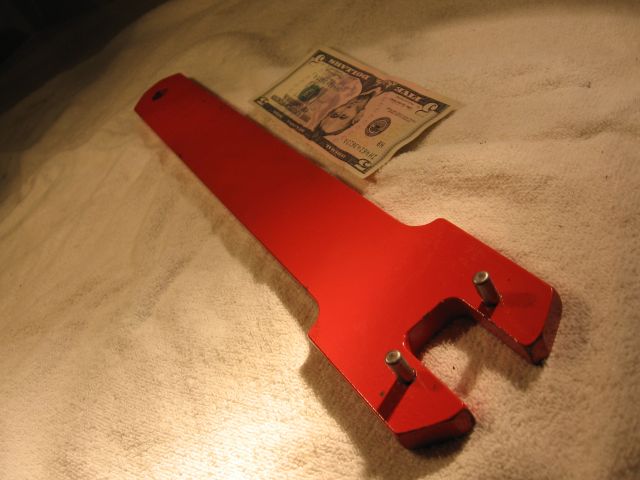

I got my hands on a adjustable spanner wrench. I will try to pull it apart tonight and see what I find inside.

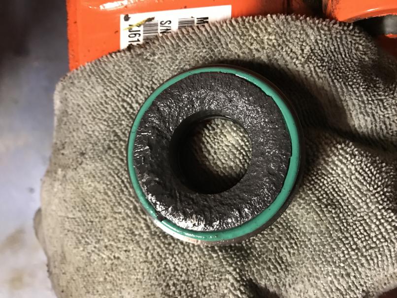

Pulled the cylinder apart and sure enough the piston was split in half.
Wow, that's a new failure mode to me. Maybe better; I'll bet that piston is way cheaper than the ram.
