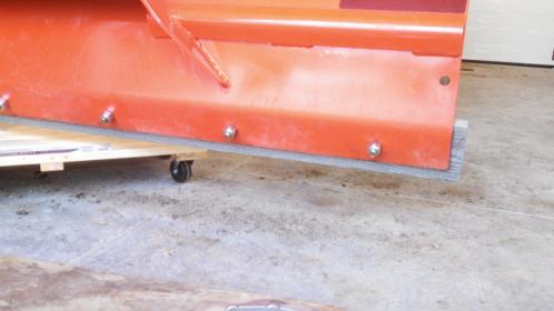

I never thought of trex. I wonder how tough it is and if will last a season I looked up a poly edge and see how much a piece of trex is.
I am still on the same piece after 2 years. The end corners have worn down as i have used the blade to clear out a v shaped concrete alley way. It was free, not sure if Trex or one of the other brands. Left it on year round since I didn't need any serious cutting edge and it scrapes fine. It is well supported by the blade, When you drill holes in it to put it where your metal edge is, you can choose how much sticks out.

I just finished getting everything done. Back blade on, rubber tire chains, hope they are tight enough and made a scraper edge for my FEL out of a piece of trex that was on sale at lowes.
How do you know if the chains are tight enough? I don't think I can get another link on the Hook and they don't seem to slip
Your posts are always interesting and informative. Earlier today I was at our local building supply yard, asking if they had any ugly/scrap TREX or similar synthetic material in hopes of capitalizing on your advice. Everything is frozen in or buried under snow so he's told me to come back on Monday and he'll have a piece for me. I'm looking forward to seeing how it works on the paved ramp area in front of our row hangar at the airport.
Lowes had them for $14 for an 8' piece
