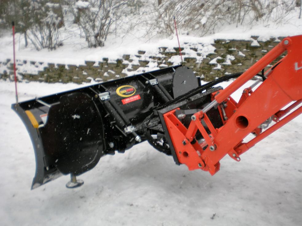

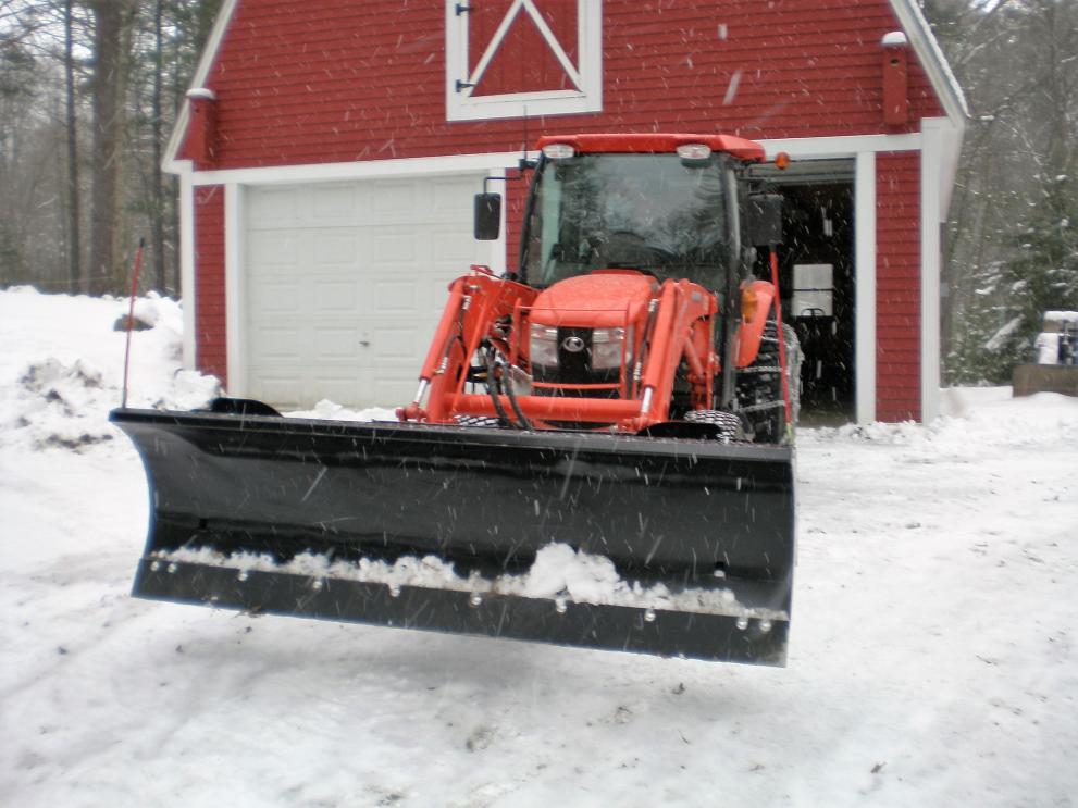

I got rid of my plow trucks as they rotted out all the time. Now I just use the Kubota on my own drive, no one else's place. I got this plow from Quick Attach, made in MN, great quality.

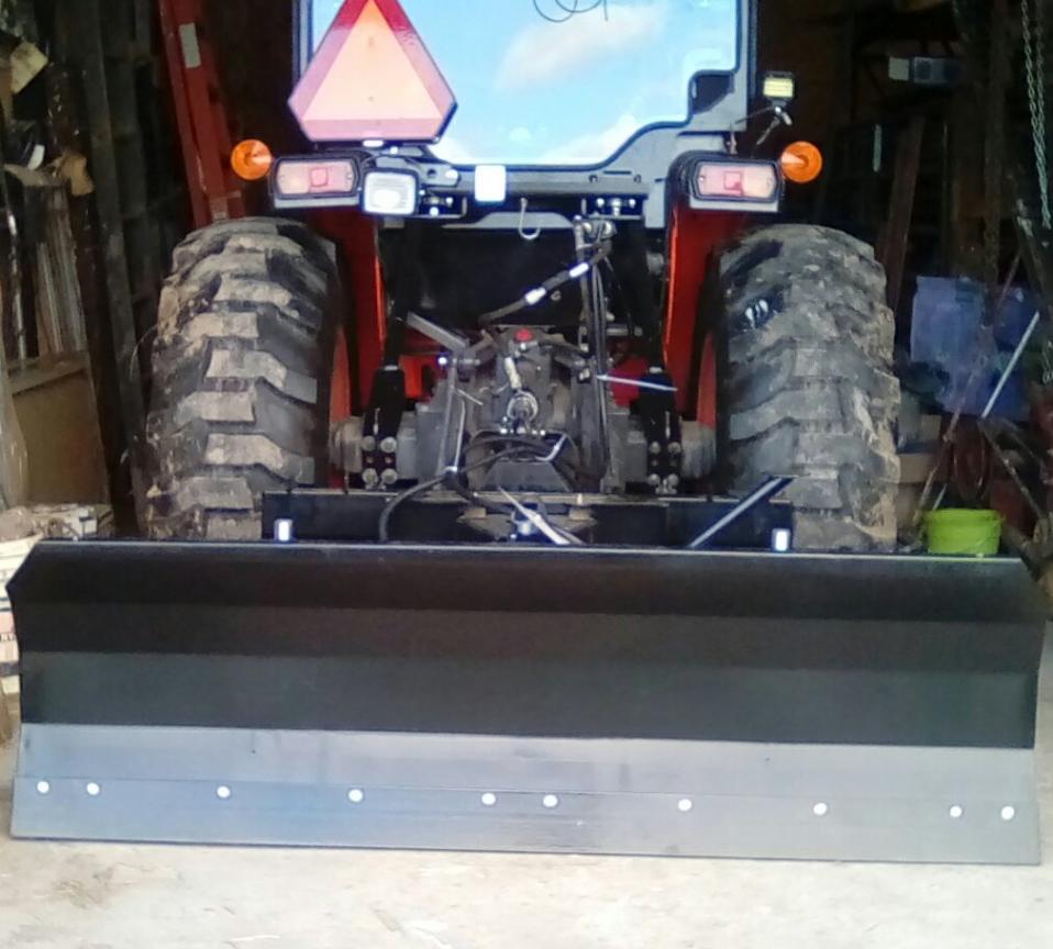

majorwager, I purchased that plow from QuickAttach.com. It cost $2670.00 and I went for the wing kit to make it a pusher for another $295.00. All total with flat faced connectors and free shipping (negotiated) it was $3090.00. As for the pictures I don't have any of just the plow, but here are a few I have of it on the tractor. By the way, that is quite a rear blade you have. It looks like a front plow, what's the story on that? Looks rugged!

Jajiu,
That is a nice unit, thanks for sharing.
Mine is indeed a plow designed for FEL mount. I do not have a 3rd function on the Kubota so I mounted on the 3 point. I use a snow pusher on the FEL w/ rubber cutting edge. My plow is a titan, S-200, 79 inch, titan shipping always included.
The titan uses a single cylinder, not the typical duel slave type, not sure if the two methods are equal. We have some snow but it is scheduled to melt soon so did not do any testing. Time will determine the investment value.
Plow does NOT have wings or skid shoes. For summer driveway grading, I like the wide skid shoes on the pusher, no crown issues w/ the drive but the skid shoes would offer the option of needed.

majorwager, this plow only has the one ram, it is heavy and working a gravel drive is tough until frozen solid. It also has an option to put pins or bolts thru to lock the trip and use as a dozer blade for light materials. I too am hoping for a mild winter as I tore my rotator cuff and need surgery. I am putting it off until late March or early April so not to deal with the snow while cripple.
