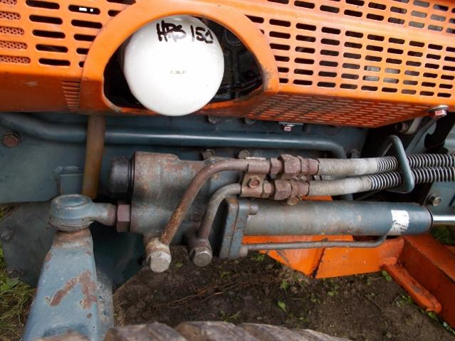

Forgive for a "shotgun" post of questions instead of 3 different ones.
My unit has power steering, but when I asked the parts guy about a new ball joint on the end of it he said there was no reference to such a unit on my tractor. The "cruise control" is missing parts on the right side and I don't see where the rod from below indexes into the rotating arm. Any Parts diagrams would help. And lastly - can someone refer me to where
my serial number would give a manufacture date? Thanks, CD

There are several ball joint ends on that unit, what one do you need?
A picture or two might help to determine if it's factory or not, and what exact part you need.

I need more pictures of the rest of the steering unit and where the hoses go to.
The Cruise control has a lot of parts to it. Look over the scematic and see what parts you need.
Might be better of getting the entire assembly form a place like West Kentucky tractor Parts:
http://wkytpstore.com/
