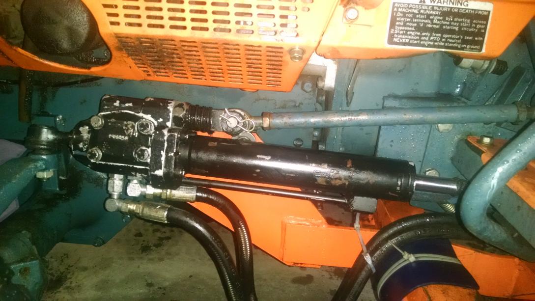

Lyle, how about posting a couple of pictures showing the cyl. and leaks. I've had two different cylinder setups on my B8200.

I attached a photo of the power steering cylinder, hoping it shows up ok. Where it appears to leak (but not for sure) is on the back side near the front of the cylinder, running down and dripping from the two hose fittings. Of course, that area isn't visible in the photo. But maybe if someone is familiar with these cylinders and any typical leakage issues, I might know where to start. However, the fact that a hydraulic shop was unsuccessful in stopping the leaking isn't very encouraging.
Also possibly worth noting, it continues to leak even when not running. Overnight leakage will amount to several ounces collected in the basin I place underneath.

When you took the cylinder to the shop did you remove it from the tractor? If you did obviously you disconnected the hose fittings. You state in you post it appears to be dripping from the 2 hose fittings. Could it be that cylinder is ok and the connections to the hoses are at fault? I am not sure but it looks like the fittings are the style that seal with an o-ring.

The hose fittings do not appear to be leaking at all. A little further investigation has revealed that the leakage is from the plunger or actuator on top of the cylinder (pardon my not knowing proper terms for the parts, as I have no access to any documentation on this cylinder assembly). When the steering wheel is turned one way or the other, that plunger will go in or out, which apparently works some internal valves, which then directs oil flow to one side or the other of the cylinder to move the piston. (That's my best guess of the situation.) Even with the engine off, when working the wheel back and forth with even very little force, oil will leak out of the area where that plunger is, and it will continue to leak afterwards, leaving a sizeable puddle on the floor next morning. I guess the next step will be to remove the cylinder again and either do some cautious disassembly myself or take it to ANOTHER hydraulic shop where someone competent will know what needs to be done. Hopefully it just needs an o ring or packing, but why the $200 cylinder rebuild job didn't take care of that is beyond me.

This is a shot on the dark, but that is like a control valve,if bore is worn out, and if shaft is worn also, there isnt a hope it will hold oil in. As in any movement up and down or side to side. May be time to visit a machine shop.
