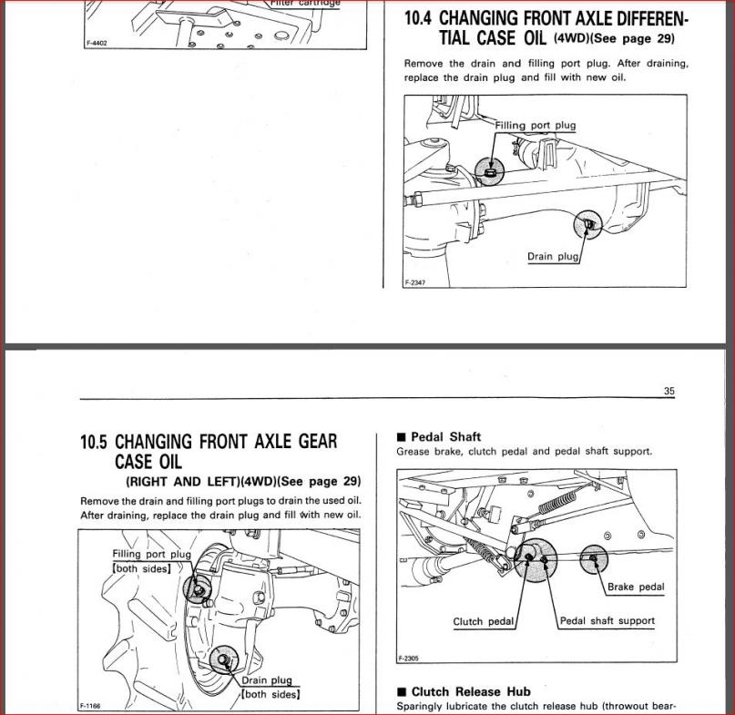

I am changing the oil in the front axle of my older B8200. I drained both sides at the bottom at each front wheel. I removed the fill filler plug on the top of the axle on the RH side. I filled it with the drain plug out, none ever came out of either plug. Do you have to fill each section at each front tire and the axle separate ?

The L4610 at work holds a lot if oil,it takes some time to run through the bearings,if i recall there are level plugs also. Near 5 gallons if i recall.
