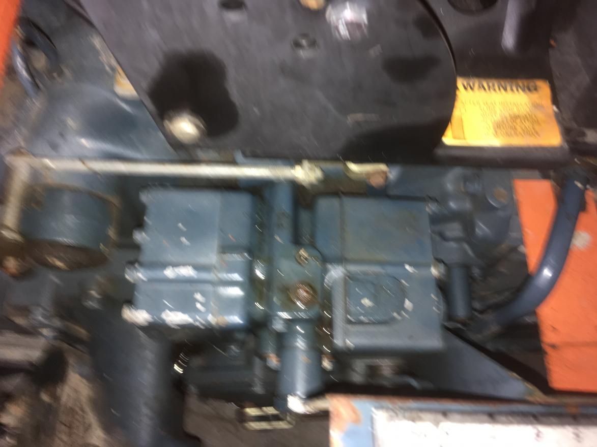

well the diverter valve and hyd pump seem to work well .. took the control box off and open the control valve section ( towards the front ) and found a lot of of what looks like congealed oil .. the issue was that at 2600 rpm I was getting some oil flow but the arms would not go up. Whats funny is that after removing and resetting the hyd pump prior to this they worked for a short period of time.
question is if I disassemble the entire unit what should I be looking for besides something obviously broken

well I rebuilt the the 3 pt best I could , replaced the gaskets and the seals and still no 3 pt operation
