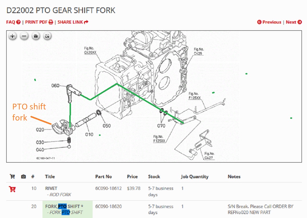

The tractor has a two speed pto. 540 and 960 rpm.
Not. having access to an Owners' manual it is not clear if there is one lever to engage the pto and a second lever to select the pto speed.
The two levers appear to move the same fork but this is a guess.
The parts illustration is not clear but it looks like there is one shift fork #60 to engage the pto and select one of the two speeds and possibly and OFf position.
Please look at the following illustrations.
What I would surmise from the above is that there is far more outside the transmission to come loose than there is inside.

a little update. I was able to take the plate off the top of the case that you can see in the pictures above. I am able to feel the lever (60 in the pic) moving when I move the PTO on/off lever but of course its not doing anything or appear to be connected to the fork. I can not see much else as there is not enough room, I drained the gear lube also with no additional luck to get a better view.
