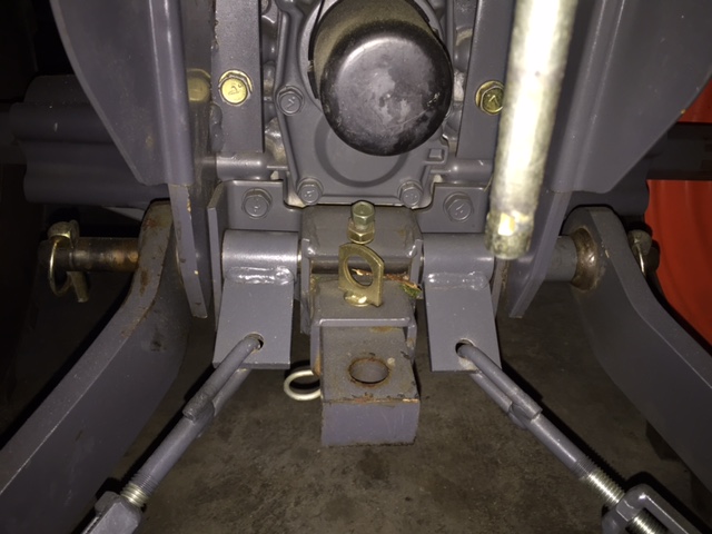

I just got this beauty, only 256 hours!!!

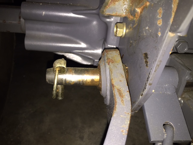

When looking at the three point hitch, it appears that there might be a spacer missing from the left side of the inner three point hitch connection.
I just want to make sure it's right, so I don't break anything.
Thank you for the HELP!!

You are missing a collar. A welding or machine shop would be able to cut you the proper piece of tubing, or private message me and I can cut you a piece- I have the proper diameter tubing.
