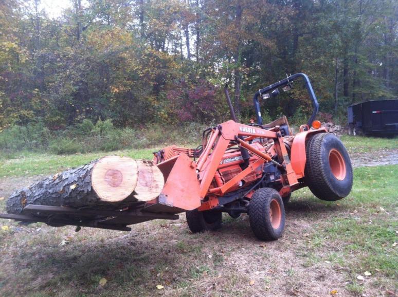

I shimmed my B9200 BF350 several months ago and LOVE the results. Only downside has been that I cracked both of my front rims with the heavy loads. Even with a counterweight, the machine can lift the rear off the ground. Not for the faint of heart! If you're comfortable with your machine and have been operating it for years and need a little more oomph, then its a great mod. However if you don't like the machine teetering on two wheels, don't shim too much ;)
