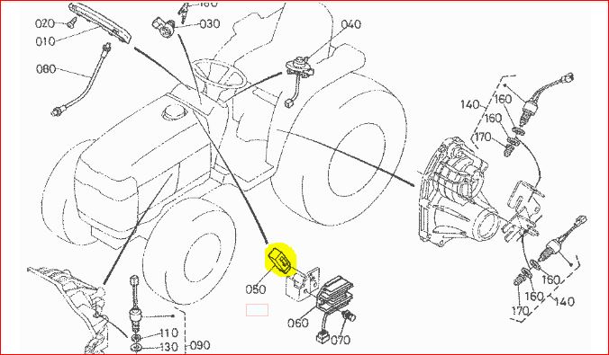

Thanks for your help! I'm not sure where the flasher is? Do you know? I can't hear a clicking sound either.

33,464
8,744
Here is the location and the look of the Flasher unit (marked in yellow) it's a rectangle unit behind the voltage regulator. ;)

Thanks everyone! I've located the flasher and I'm pretty sure it needs replaced. Does anyone know the best place to order Kubota Parts?
