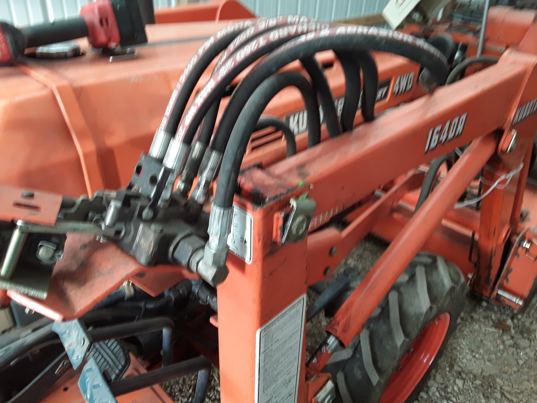

Can you include some pictures of the plumbing from the loader valve to the tractor?
Loader is 1640A.
No front mounted pump.

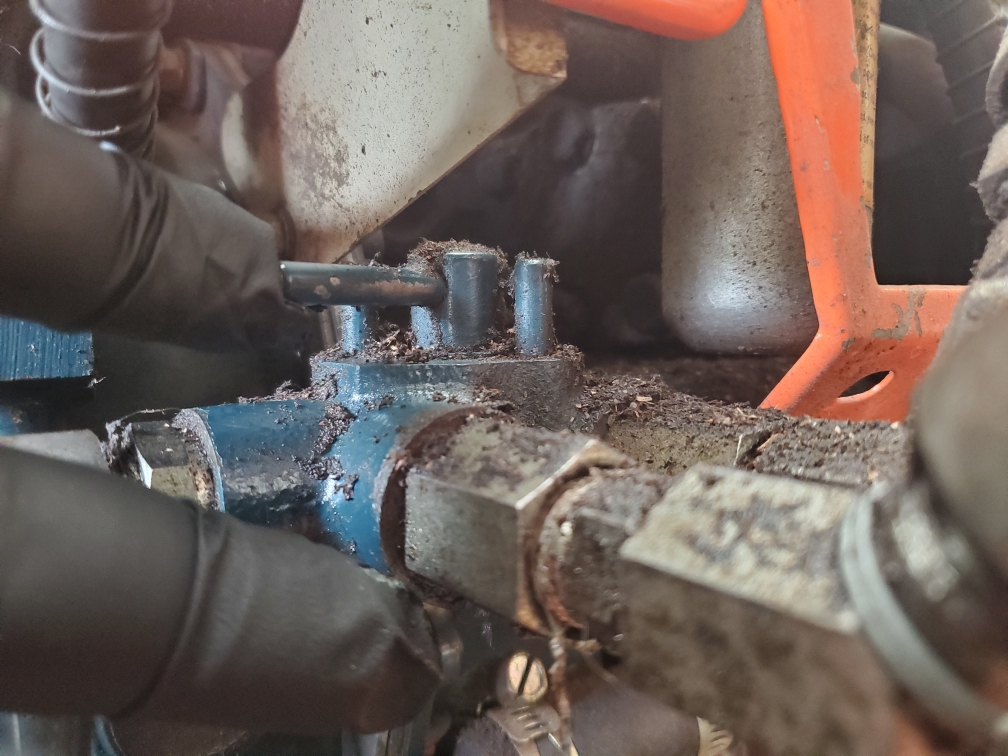

I might have found the problem but cant confirm until I get the 3 pt.valve back together.
Thank you for the suggestion of a valve, there's a small one on the hydraulic block for the front loader connections.

I may have found the problem.
There's a small valve in the hydraulic block at the front loader hose connections. I was chopping weeds/brush along a fence row right before I noticed the problem.
I switched position and now have fluid coming out at the 3pt valve feed.
Now my challenge is finding gaskets to rebuild the valve, many parts are discontinued.
Thank you very much for your help.
Can't confirm until valve is reassembled and installed but im hopeful.

Yes that's the selector valve and if it's the wrong direction the loader will work but the three point will not.
That is why I wanted to see the hydraulic hook up to see if that could be an issue.
Your on the right track!
