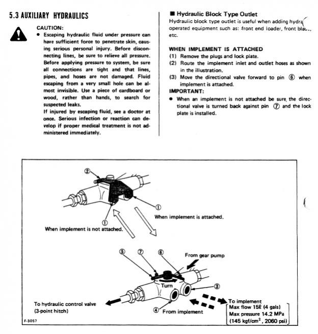

What do you know about the relief valve that is in the block where the pressure comes from? The selector block.
I might go get a picture of that block. I don't think there is any relief valve there. A vavle to shut or divert the pressure. I'v never done anything with it. I don't think the loader has ever been off since day one but I could be wrong.

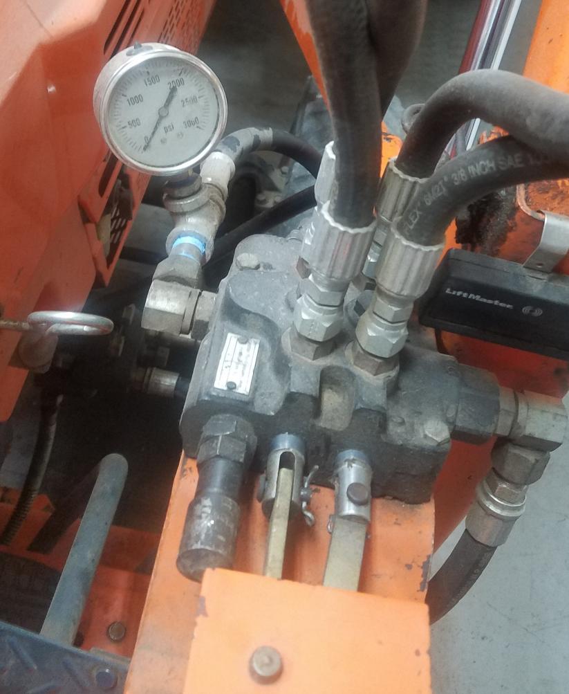

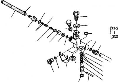

Dave
Attached are a couple pics of the valve. Like I said I have never messed with it. Maybe I should. The one picture shows a valve(I think) with nut located between the two hoses the other kind of shows a valve on the top towards the back. It just has a shaft sticking up with a rod. I thought I read somewhere that is to divert the pressure. I'm sure you guys know. thanks again for the help.

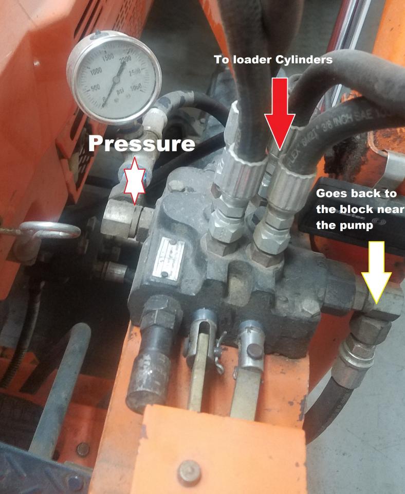

The pressure relief valve on that model is tricky to adjust and I'll bet you tried adjusting the wrong valve.
Some mess with the valve in red and that is not the pressure relief valve, disregard the blue (drop speed adjustment), you want to adjust the yellow if you even need to.
Now a slow loader is normally not a pressure issue it's a flow issue, when was the last time you removed and cleaned or better yet replaced the filter?

I've seen your picture before when searching. I adjusted the one behind the slotted head. When I bought the tractor a little over two years ago I dropped all fluids and changed filters and cleaned the suction screen. Oil looked good and the suction screen looked clean. Thought maybe I wasted my time and money but it was good to know for sure. I haven't changed it since. I've only put on a little over a 100hrs on it. I used Kubota UDT2. I think that is what it is called. I thought about getting some more and a new suction screen and replacing both.
