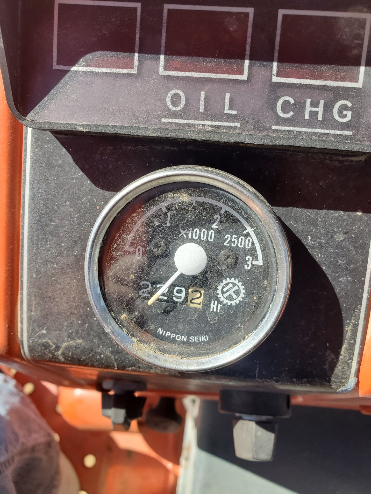

Hello everyone,
I was using the b7200 this weekend for a few hours moving dirt and am slightly annoyed my tach doesnt work. Its not that i need it, i dont ever run it at full bore anyways. Usually around 3/4 throttle but noticed the tach needle is below zero at idle. If i tee the throttle up the needle moves slightly closer to zero mark.
My understanding of this combo is that its cable driven which i assume works because it does move slightly and the hour meter still meters time accurately. Is there any type of adjustment on these things. Im a fan of original equipment or factory replacement as long as its similar in terms of functionality. I have no intentions of adding an electric hour meter or tach. I just want the old one to work. Haha.
I added some pictures. One is at idle. The other is at half throttle ish..

cable's busted...replace cable 'core'
probably can still buy a universal kit. cut new core to length, swage the end on, install in sheath,reconnect,done. takes less time than me typing this.....

Sounds easy peasy, thank you. Ill pull the cable and see what i need to get ordered up. Out of curiousity, What controls the hour count then?
Complete new cable is $28. If the meter has gone south (real possibility) its $160. Hours are an approximation derived from rev counter

Sound like the meter is shot especially if the hour counter is still working. Condensation that sometimes collects inside might have caused corrosion that effected the rev needle.

I don't think your problem is the cable since the hour meter works.

Thank you all for the help. Ill pull it apart. I was hoping for an 'adjustment' type solution. Looks like its gonna be a quirk with this thing as long as the hour meter works, ill deal with the tach the good ol fashion way. Listen to the engine. Haha

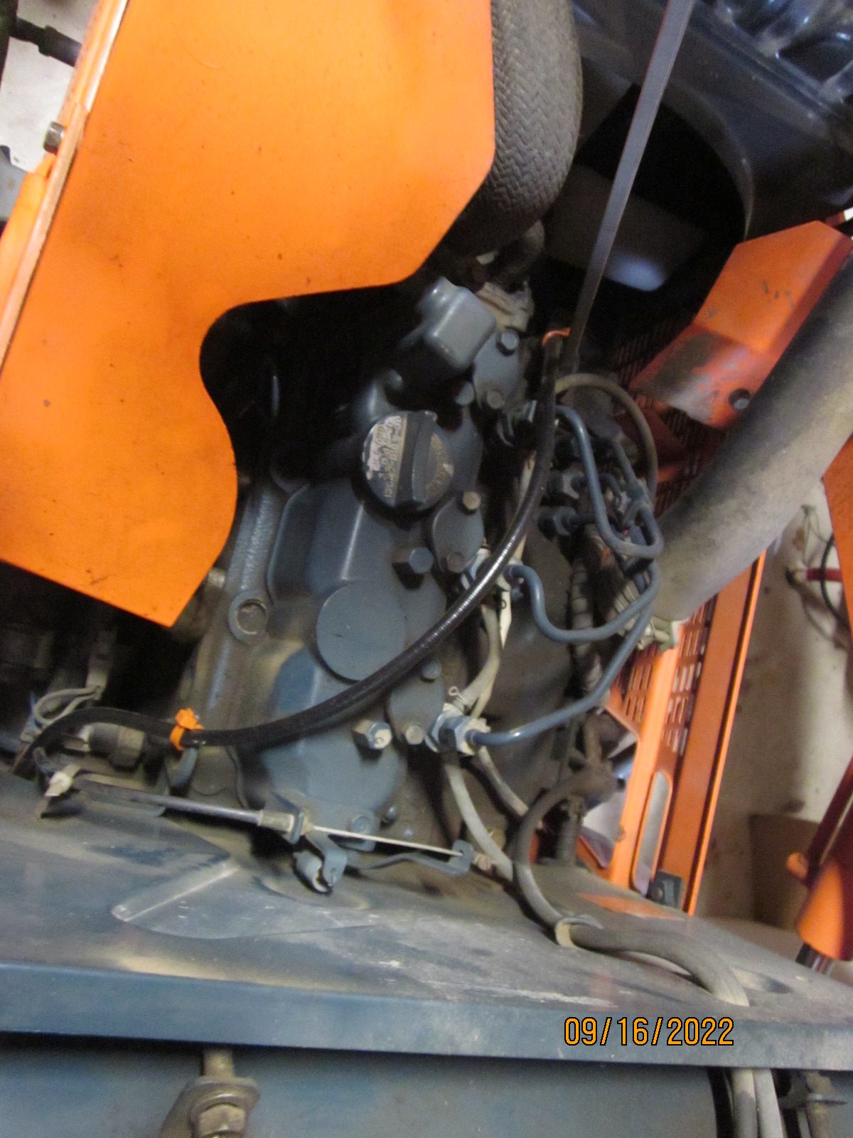

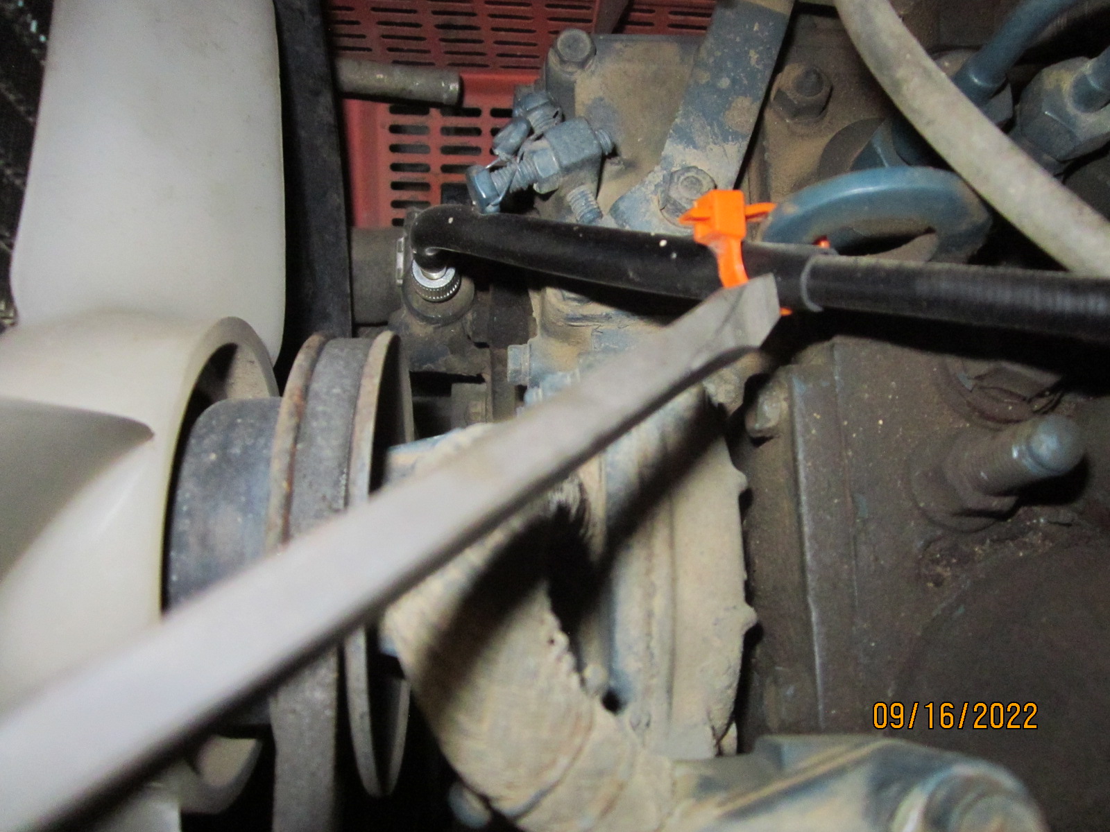

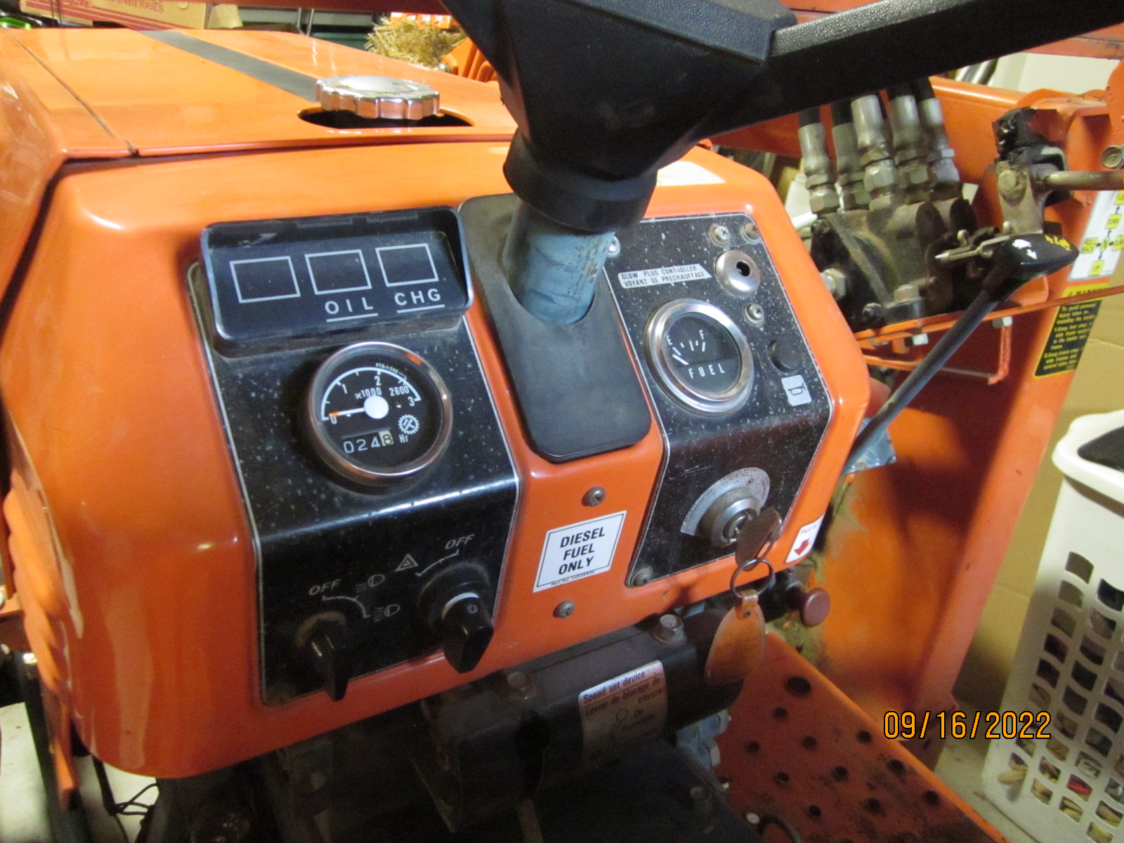

We have B8200 and my was a cable...Which I replaced for no tach looks like the same panel. I have a 2 speed PTO which by ear I wouldn't trust.
On ours one dealer told me it was electronic? If one looks at the engine ours goes to front...With no electronics! Go luck, yours may be binding? Or the meter movement could be bad. I would check the cable first...
