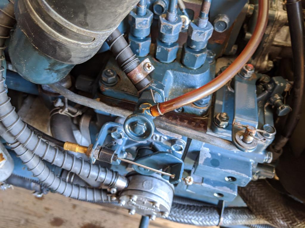

Here's a pic of my tractor and the tires I got on them. Quite stubbier than originals. Surprised to find the set on ebay, $300 for both and they are 12Ply.
A little off topic - can anyone tell me what the valve in the 2nd picture is for? I cleaned up the engine with degreaser and now it's leaking pretty good right where the valve is, also can anyone tell me what it is used for and whether it should be open/closed? Thanks again everyone

It's called an air vent. Should always be closed. The purpose is it allows you to bleed air from the fuel line if you run it dry or change fuel filter. If you go to Kubota books you can download the full operators and work shop manual for free.
I did download the manual. Just didn't get a chance to look through it all. When it was completely closed it leaked the most. Is there an O ring or something that might have failed? I'll have to look into it. Thank you once again everyone.
