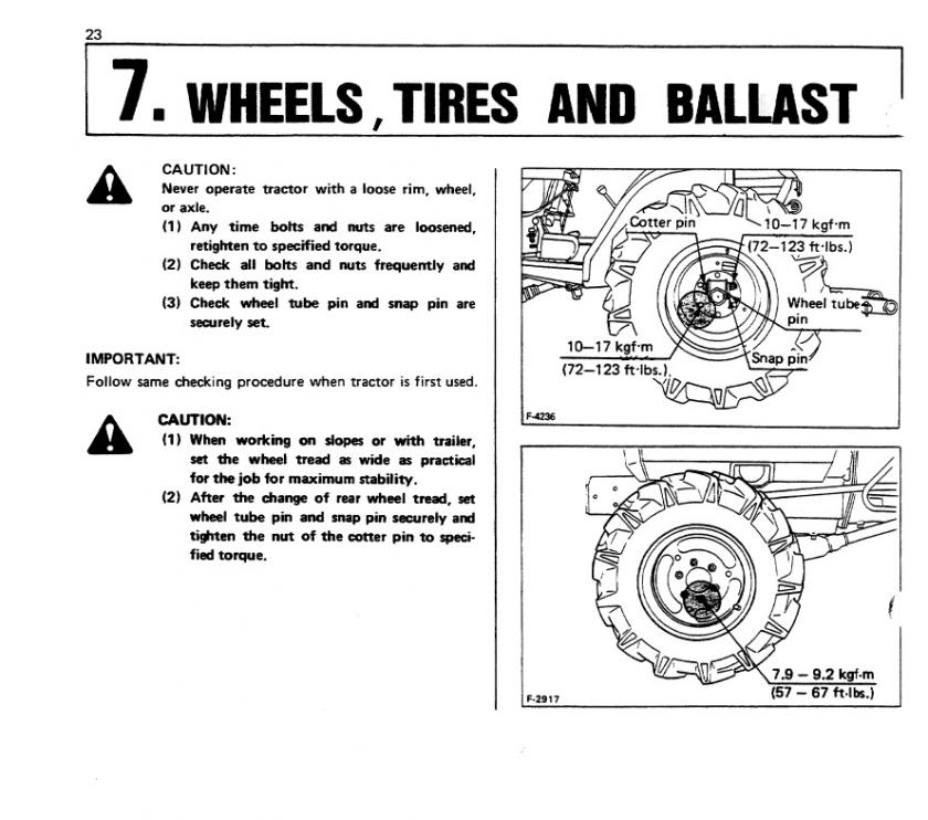

I know I saw this once before, but I've been searching for the last hour and can't find it. Lots of posts on loose hubs, but nothing about the bolt torque. My hubs seem to be OK, and no visible wear as I've seen in some of the posts. I just want to torque to specs. I've looked through the operator's manual, but that's about the only torque spec they've seemed to omit. I "think" I saw 75ft lbs somewhere.
Anyone know for sure? Or where to find this?

I would think that 55-75ft lbs would be a plenty, most of the time TOO much torque is applied, I would tighten them, check after a couple of hours, and then recheck again to see if anything needs a little snugging! :D

I did see that post in my searching, but wrote it off as wheel bolts, and not hub bolt. I would think specs for a bolt, regardless of application would probably be close, as long as female threads are ample for length of bolt. I'm 14 miles from one Kubota dealer, and 10 miles from another. Maybe the best thing to do is go ask. Usually is last option for me (and directions).
I'm saving off that bolt chart though. Looks like it could come in handy.

The hub in this drawing looks like the newer style hub. Not sure when they quit using the old style.
I did stop at my Kubota dealer down the road and the parts guy found the spec in their shop manual. I was told that it's 72.3ft lbs. Why not 72 or 73? Who knows!!
