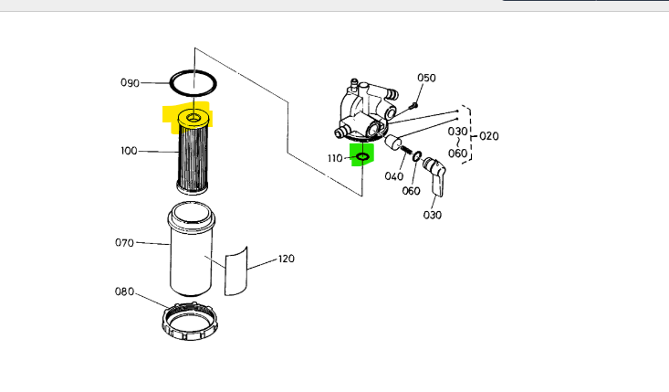

I have filled the fuel bowl in the past but it was very messy as the filter needs to be squashed a bit to get it in, and I have left it empty. Both seem to work! The fuel filter is OEM and is the correct part but it does seem to need its fins kinked a bit to get in the fuel bowl. I have always thought it odd but it’s been like that for the 10 years I’ve owned the tractor.
33,423
8,716
It should not wrinkle or kink a new filter when installing it.
Look up inside the housing, it's very common for an old filter end to get stuck up in there (yellow), or someone has doubled up the small O-ring (green).
