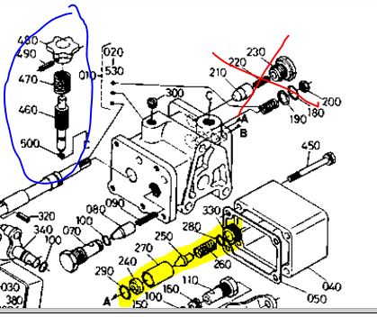

So I believe I finally found where the adjustment needs to be made. I went to kubota's very user-friendly website. The purple areas highlighted I believe is where I need to add shims. I guess now my question is has anyone actually done this, and when I open up that cover what am I going to expect? Thank you in advance...

Well, here is the inside of the relief valve housing. I backed out the large hex head on the right to get at the relief valve. There was a small spring that was in an indentation on the back side of the hex head and a bullet shaped circular piece of metal that also had an indentation on it. Diagram shows there's supposed to be a shim in there but there was none. So basically the spring was held in place by the two "female" ends of the hex head and the bullet shaped circular piece of metal. I put everything back together after adding a few shims and only raised my PSI 100 PSI. I put almost 7 millimeters of shims in there. Now I am wondering if the issue is why spring is too old and weak. I am going to try and find a replacement spring that will provide a little more resistance and see if that is the issue.

That is NOT the relief valve, take it apart and remove the shims.
The relief valve is under the adjustable plug with the slotted head.
You shimmed the poppet valve in red, the relief valve is in Yellow, and the drop speed adjustment is in Blue.
