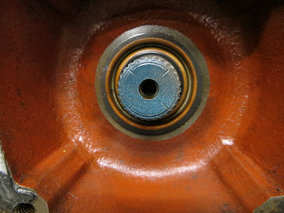

Just checking to see if anyone out there happens to know the part number for a B7200 brake shaft oil seal. These are dry brakes...supposed to be. Ordered a new one from local Kubota dealer, and after a week of waiting, found that it was not the right part. You can see the pictures of the shaft with the original seal, then the new seal hanging on the shaft. I think it's a little loose.

Did you get the "right" seal?
Is the seal tight in the hole on the outside dimension?
If it is, then you have something bad going on as the shaft is nowhere near center.
I'm hoping the seal is the wrong one and it's loose in the hole.
The picture with the seal hanging on the shaft is part number 66466-14960, which apparently supersedes 67401-14960. Regardless, it's way too big. I measured ID of the spline shaft and got @ .870. This seal is over an inch ID. I'm pretty sure OD is way off too. The numbers seem to be right, but it's definitely not right for this machine. Will be heading to Kubota dealer in the morning to see what they have to say (and return the seal). I have yet to remove the old seal. Have learned that lesson!!

OK. I mentioned lessons learned about removing old seal before new one is in hand. May have worked against me this time. Went to Kubota shop. After a while of scratching heads and looking at pictorials for the tenth time, a mechanic came out an mentioned something about a sleeve, which to me looked like it was part of the seal. It wasn't, and that's why the seal ID looked large. Sleeve was "probably" ok, but for $9 I replaced it.
Sleeve part# 67401-14970, and was stock part a dealer. Must be used elsewhere.
