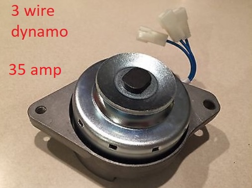

Some time ago I did some research for someone who wanted to do the same thing.
What I discovered was that John Deere used a 3 wire dynamo with a 35 amp output or about 3 x the typical two wire Kubota dynamo. You would have to use a JD regulator/rectifier but it seemed to be the most compact way to increase charging output.

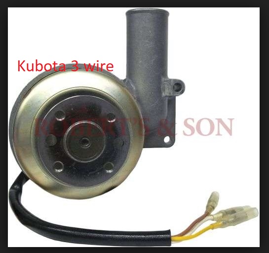

I also came across a B7100 style water pump dynamo with 3 wires. Someone may be able to read the name across the photo below.
Another member posted a very complete description of how he added more charging to his B7100 which you may be able to find with a search.
