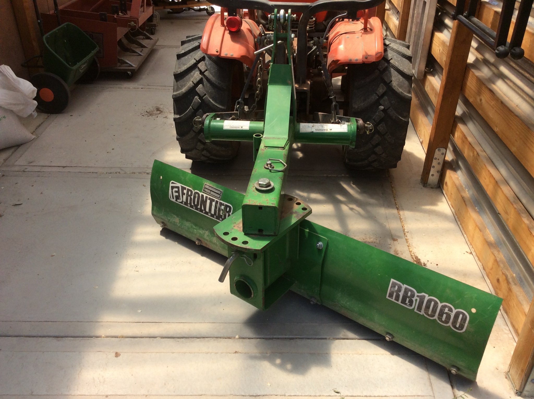

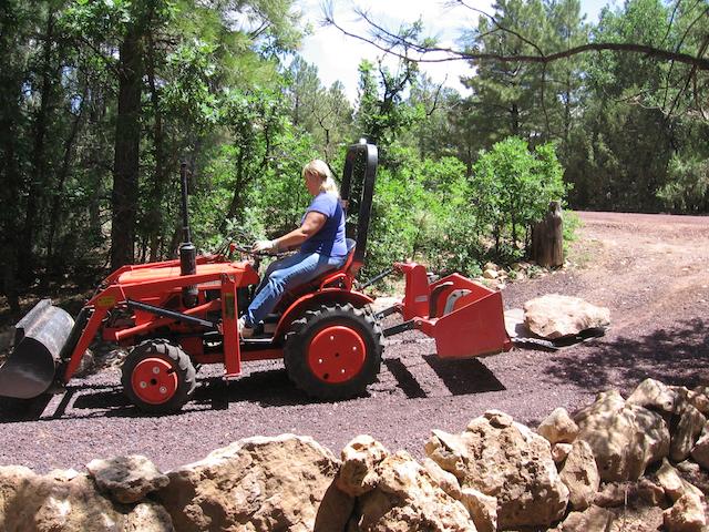

I used to have a tractor the size of a B7100 and ran a 54” box blade with no problem. I like a box blade to be a little wider than the wheel width so you can work close to a fence or ditch. But for what it’s worth, I find a rear grader blade to be far better than a box blade for road maintenance, especially if it has an offset function.
