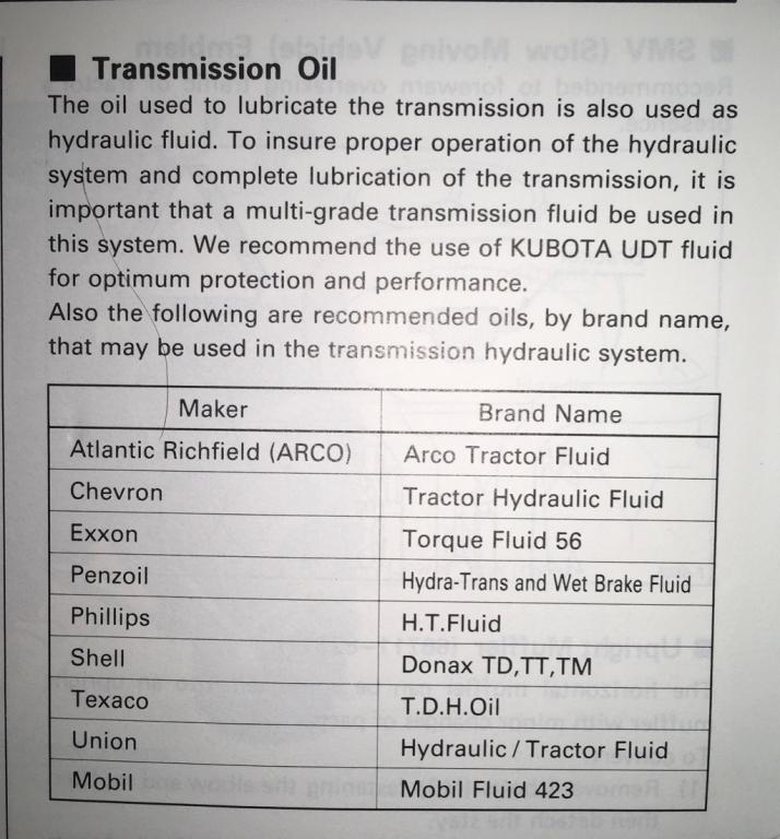

you might find this useful, from my 1997 B7100hst owners manual.
My manual specifies 13.5 liters or 3.6 US gallons.
Keep in mind the manual for this tractor was written 22 years ago, products names etc may have changed or modern alternatives might be a better choice.
