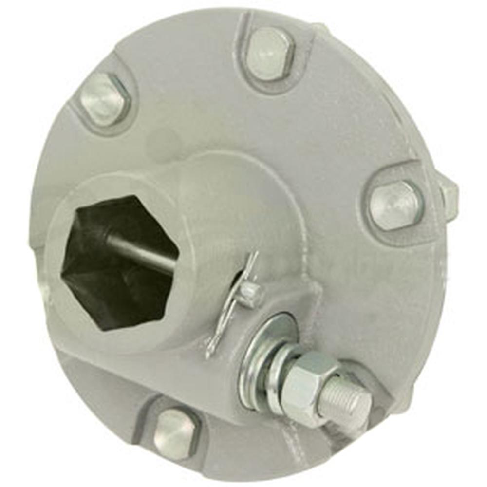

So i wen on ebay looking, AND after getting sticker shock at Messick's for one whole assembly (365$) ebay has this and it looks to me like it might work and doesn't look like a spacer is needed as the two bolts tighten it up. Here is what the ebay part looks like.

here is a cheap replacement on ebay 56$ THAT I AM HOPING WILL WORK.

Yes you have 2 different hubs, the one is broken.
Here is another one of the same style (way better style) as the good one on your other axle.
Yes it's a little more $ than the one you picked, but trust me when I say this is way better of a design.
Thank you so much ! that looks a lot better I'm going to order a pair of them tonight. Its the best tractor i have ever had ....Old like me and reliable. With the help of this site i have been able to do everything myself.

Wolfman... I ordered those hubs and they came in 2 days! Man they are heavy duty compared to what was on there or those ones i showed in the picture. All i need now is some good weather so i can work on it. Thanks for your help... much appreciated.
Rick
