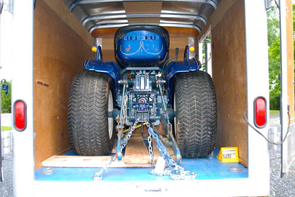

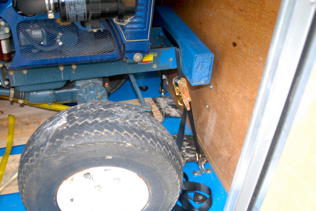

I just bought my first Kubota, a well maintained one owner B7100 with 442 confirmed hours. I'll be picking it up sometime this week.
I'm transporting it in my enclosed Wells Cargo Trailer.
Any tips for securing the tractor in the trailer for the journey back to Vermont?
