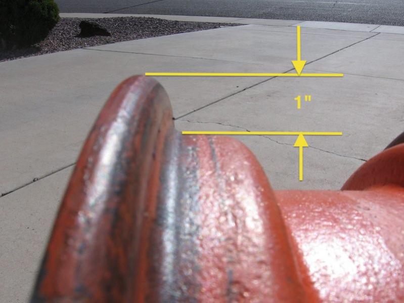

Today, I took my new rear tires & old B7100 rims in to be mounted- after a long time, the manager told me they could not mount the tires on my "oddball" rims. He showed me that the recess on the new tire for the bead to seat is about 3/4"; the lip on the rim is about 1". The bead would not seat on the rim, it was actually trying to seat on the writing on the side of the tire. He brought out a new 16x6 truck rim & the new tire popped right on & sealed- the lip was 3/4".

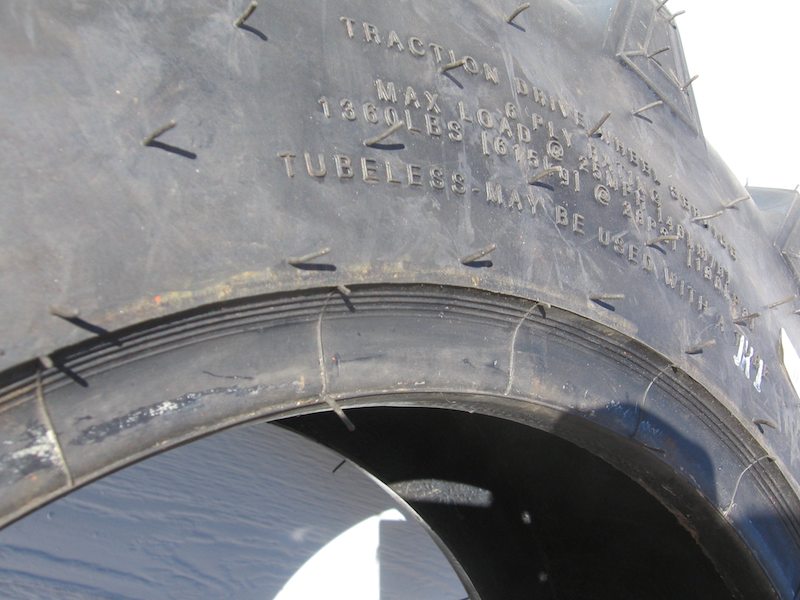

I went home & compared the new tires with the old tires & sure enough, there is a 1/4"+ difference in the bead recess. So, apparently, I have odd rims- one guy said non-US rims used to have a taller lip.

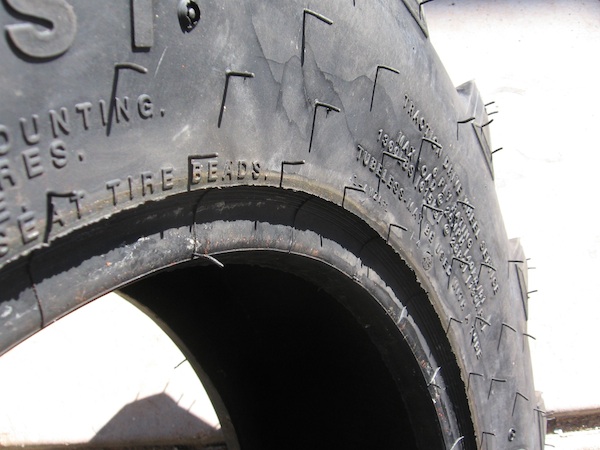

I had them remounted at a different shop, same problem. Tire seller said he would take them back & refund the price, if I ship them back. OK, I'll eat the loss, but what do I use now? The problem tires (Carlisle) are 31.4" tall and a bit short for the 4wd ratio. The seller I'm dealing with also has BKTs without the bead protection recess, but they're only 30" tall. Crap.
Shot some pics of the tire after mount/dismount and it shows a witness mark where the rim hits. It's subtle, but there- kinda scuffed/dirty/orange.
