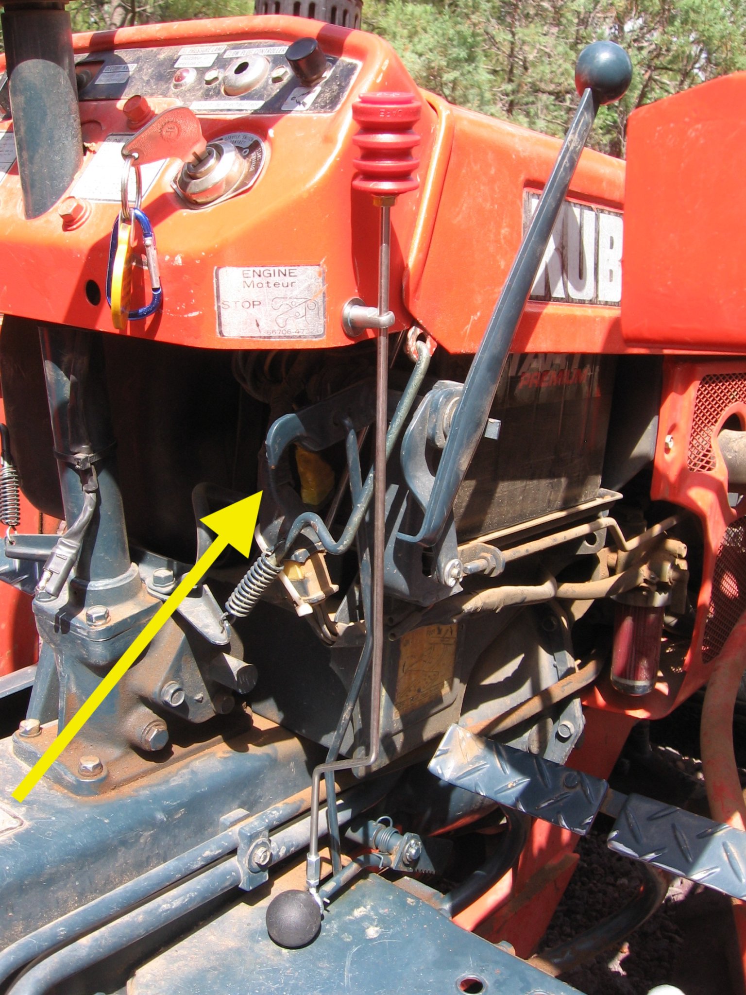

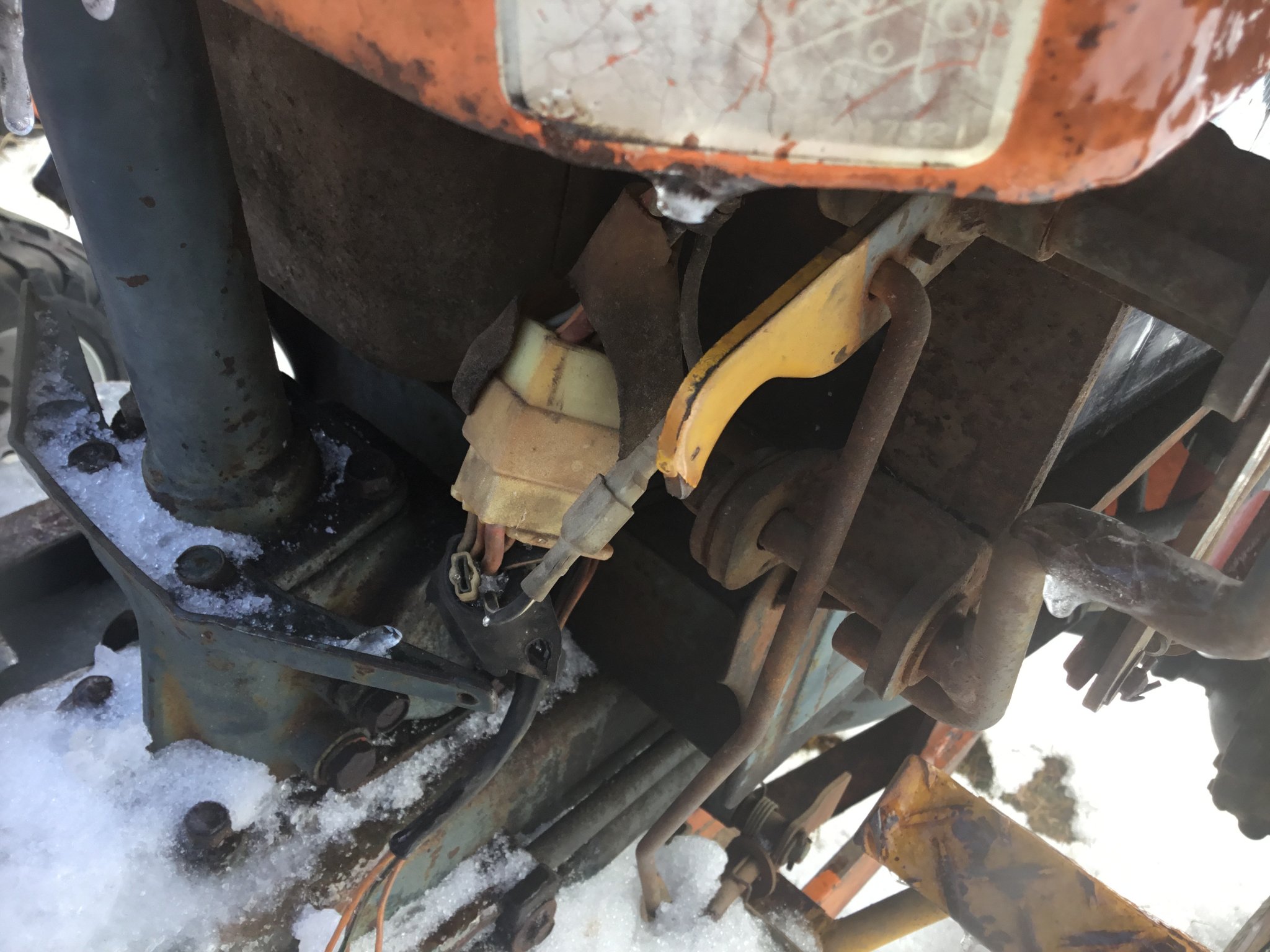

Small yellow lever is stop lever on my 7100 throttle lever won’t kill it....
Kill lever below throttle
When I hear 'run away' or 'over revving' I think of over the full throttle setting and NOTHING stops it.
The B7100 kill 'lever' and the throttle act on the same shaft to the injection pump. If you can shut down with the kill lever under the dash then I think your linkage is screwed up somehow or your snow shoes are pushing on the foot throttle (wink). If you can shut the engine down with the throttle lever you have a whole different problem.*** There is adjustment on that linkage.
I can only wish for a freshened engine in my B7100. But at my age the machine's power and the hydraulics are just self adjusting to my capabilities and have declined over time. It's perfect for me.
*** Do you have a B7100 service manual? I have no ideas what's under the injector lever's top cover with the four screws. There have to be two springs that return the engine to a low idle position. One springs the lever home from High to Low idle and the other from Shut down to Low Idle.
