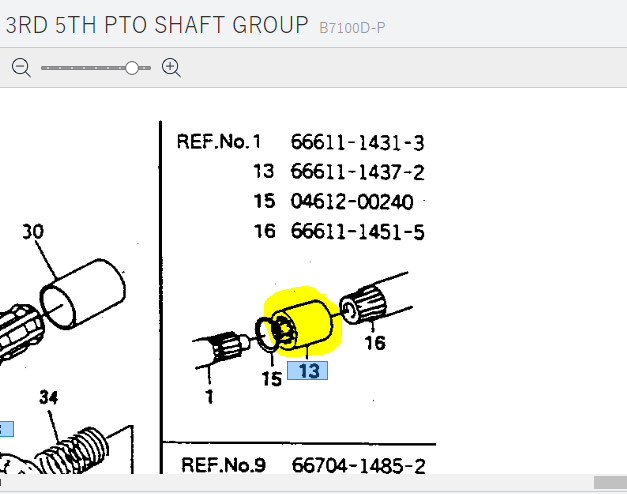

After replacing the PTO seal on this non-HST B7100 D Kubota, the PTO won't spin!
This tractor has a PTO selector lever on the operator's left, with three speeds and neutrals in between. It is necessary to disengage the engine clutch to do the shifting.
The PTO was working before the seal was changed. I removed the PTO plate and PTO shaft during the process, and refilled with new gear oil after a drain.
Oddly, when in PTO speed #3, the shaft will manage to rotate just a little on its own but then stop.
I am very puzzled.

Manually turn the PTO shaft CCW with your hand, do you hear a clack clack clack?
Did the bottom shaft come out at all when you pulled the cover?
32,801
8,310
You sound like you might have a very old model with no one way clutch.
You'll need to pull the cover back off, pull the bottom shaft out then go fishing for the coupler, it will be laying in the bottom of the case.

Thanks so much for your assistance!
That must be what happened.
Glad I won't have to split the trans!
The tractor serial number is 87001-41171. The parts list which came with the tractor, does not show a one-way clutch.

Just as North Idaho Wolfman indicated above, the problem was that a coupler dropped off the shaft when I took it out. It was on the bottom of the trans housing, just behind the pto plate. All is well now.
