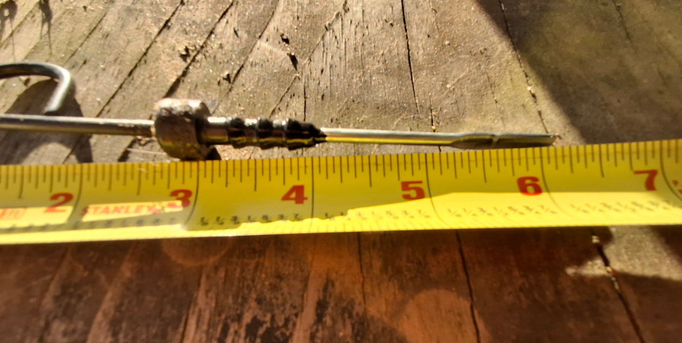

Here is the info - I hope it is what you need
3" mark at stopper to deck - full mark at 5 5/8"
So - 2 5/8 down from top on level ground is full ;)
( THis is on an HST model btw)

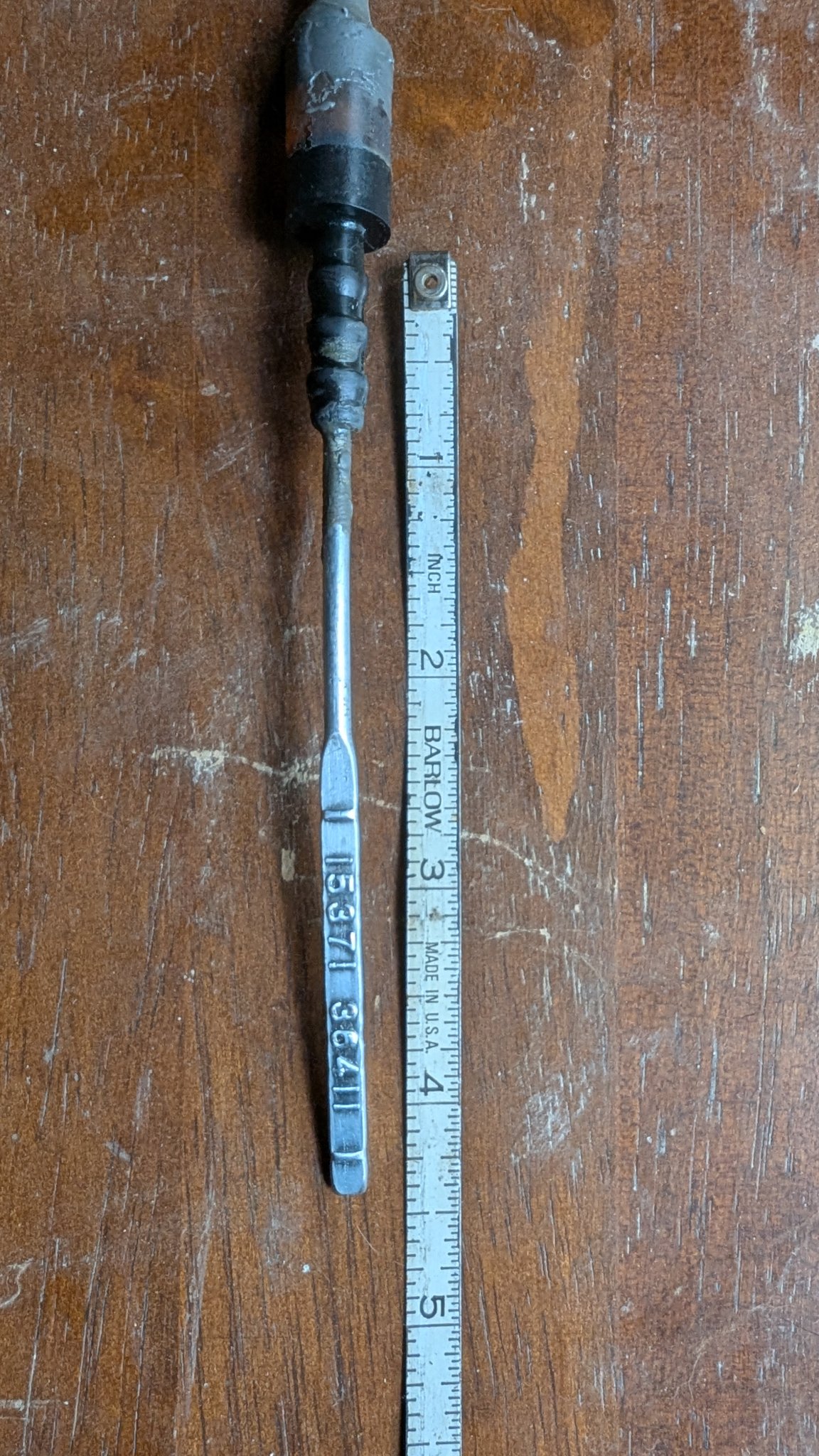

Thanks for the pix. I've always wondered what the 537 and 364 meant. Different models? And the other marks?? Looks like I guessed close enough to just use the top mark for full when level:

@JRHill
I think there is only two actual LINES on the dipstick. The very upper one is “full” and the very lowest one is “low”.
The rest of the stamped marks is a part number = 15371-36411. But that is not the part number you would be able to buy. It is some stock part number for the factory when they built the engine.
But the ones do look like some line also!
Look again, those lines before and after are "1", so it reads 15371 36411 -- the Kubota part number for that dipstick.
