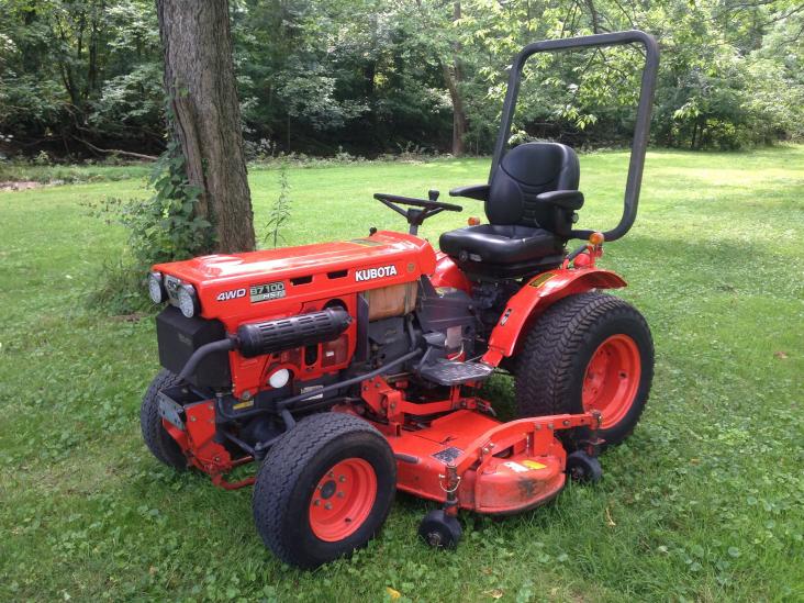

Found some LEDs for the headlights. Had to do some modifying, and build a new bracket to make them work. They turned out great though, and dang their bright. Hope the pics work.

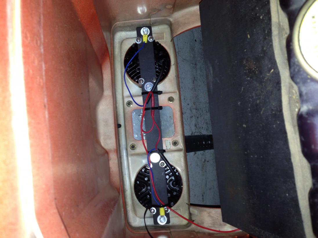

Here's the link. Now I must say, it wasn't the easiest thing I've modified but luckily I have the right tools to help quite a bit. They were quite a bit to large but I was able to mill them down to fit. The bracket was tricky to get the spacing just right. They do stick out in front of the hood a little but there wasn't much choice in that. I'm really happy with them.

Great Job!! The lighting looks awesome! Do share some more pictures of the rigging.
