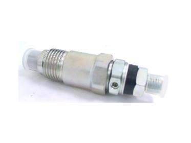

edit - looks like 70000-65208 does not come with the hose barb ring (see attached pictures) while 70000-65209 comes with the Y hose barb ring.

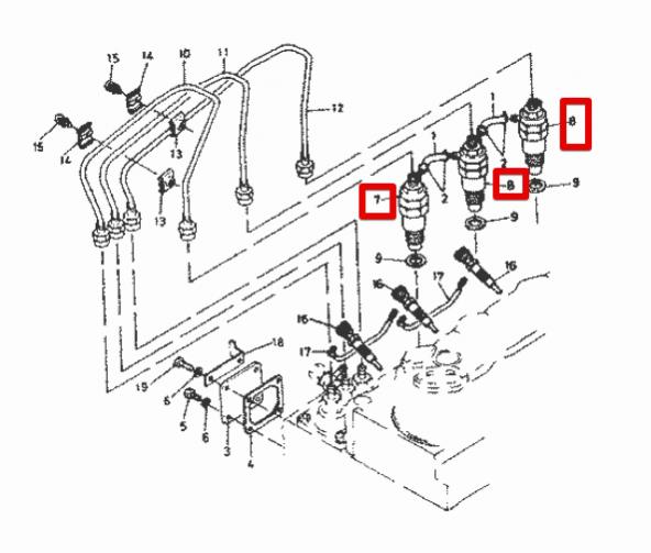

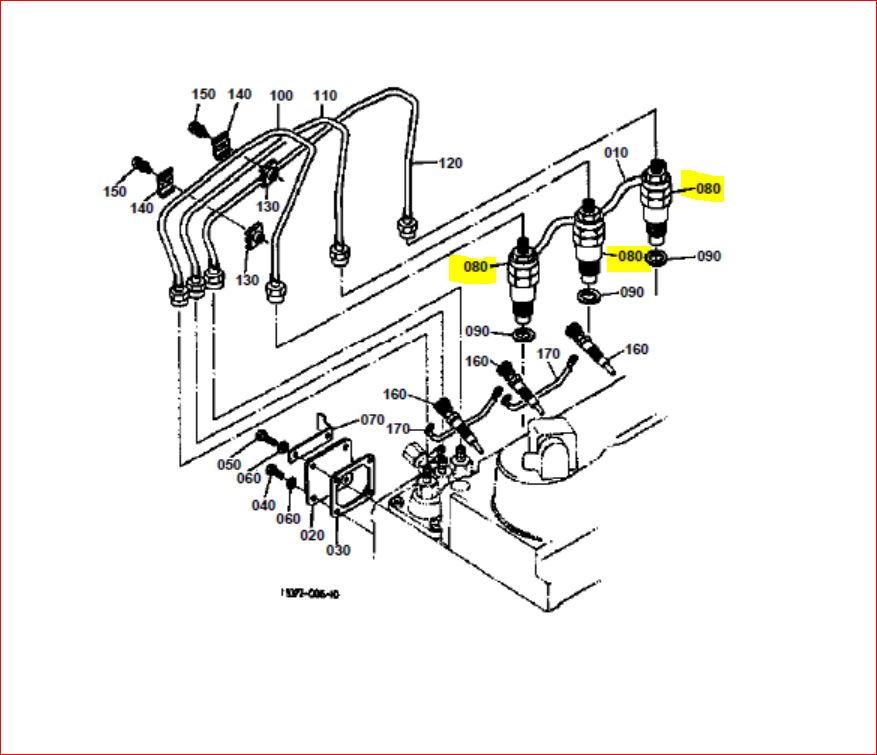

I don't know where you got the part# 70000-65209 , but that's the wrong # for that motor
You want the 70000-65208, that is the right injector for all three cyl. in both the old and new serial numbered tractors.
Oh yea, I would go new.

This situation is where I trust the factory manuals over aftermarket! ;)

The difference is that there was 2 different return line setups, Mine uses a solid steel line set and newer injectors used rubber ones.
I would save the funds and get the cheaper ones and reuse your fittings. :D

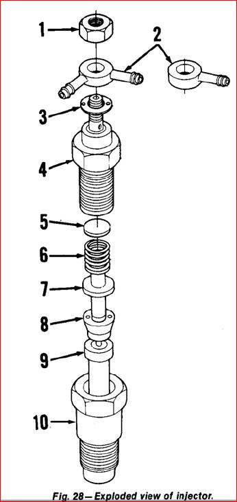

Here is a part layout to compare with.
#7 is cupped on one end and should point down.
