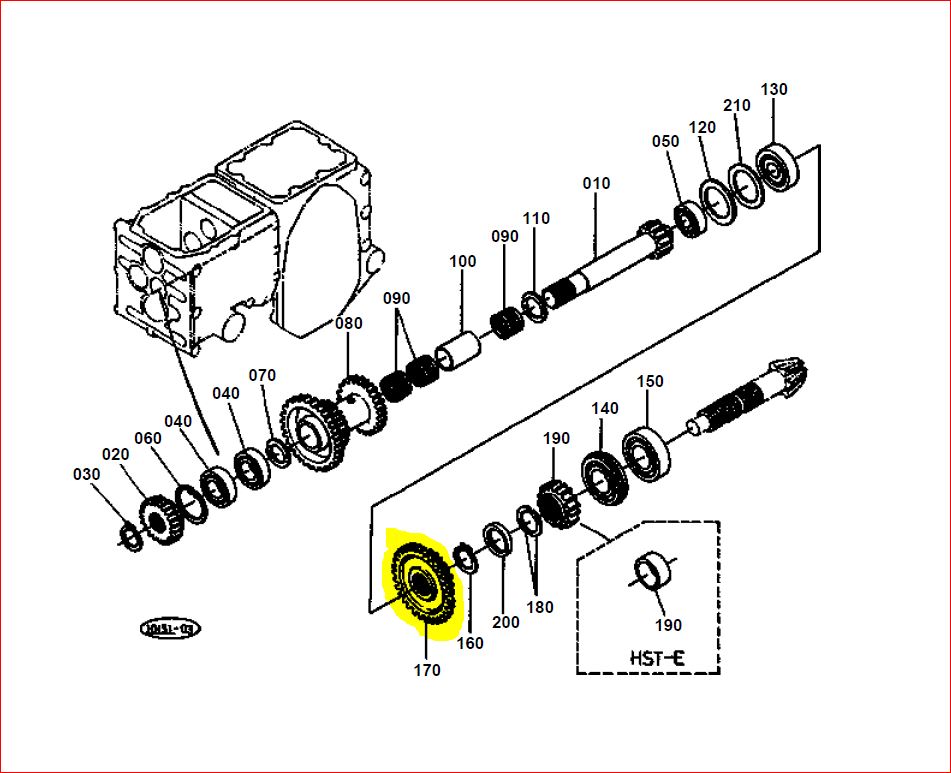

33,379
8,695
I haven't been into my B7100, it's always run like a champ.
I have gotten into my L3450GST, way into it.
The good part is you won't need to get into the HST unit (it will just unbolt from the front of the mid-case).
It's the mid-case where you'll most likely find the broken gear.
Go to Kubotabooks.com and download the parts book and the WSM that will give you a lot of visual parts info.
My guess is the gear in yellow:
