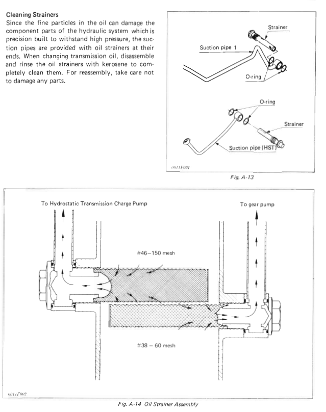

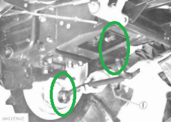

Vigo
B6100, B8200
Jan 9, 2022
595
342
San Antonio Texas
So let me stick my foot in my mouth here, since i dont know a damn thing about a b7100 HST specifically...
The 3pt and 'other lift' you mentioned are run by the pump on the side of the engine. It has nothing to do with propelling the vehicle (unless it pumps all your trans oil into your engine and runs the trans dry), and it has worked this entire time.
The having movement and then not having movement is probably related to losing 'prime' or 'charge' in the HST pump/motor circuit. This is likely to be related to the charge pump hydraulic circuit. The HST charge pump's strainer is on the clutch pedal side of the tractor while the 3pt pump's strainer is on the brake pedal side of the tractor.
If the two things are right next to each other and the 3pt works then it sure aint a fluid level issue, as has already been confirmed. But.. even if that strainer is clean, the potential issues could start as early as the sealing rings on the large banjo fitting for the HST strainer. Does it seep any fluid there?
If not, what about at the other end where that pipe has a hose clamped onto it?
It's most likely that that hose is the main source of the issues. Because it's location is below the standing fluid level, just turning the tractor off for a while would allow the air to eventually percolate past the charge pump and the fluid level to rise to the inlet of the charge pump, letting it work for the first several seconds upon restart. Once the charge pump is pumping, it sucks air from this hose section which gradually displaces the fluid which is normally leaked back into the case from the HST pump/motor circuit until that circuit is substantially air and it ceases to be able to move (probably gets louder as this is happening as well). The filter, and the fitting which leads out to the cooler are also fed by the charge pump, which is why when the charge pump starts simply cavitating in air, you have no fluid out of the line to the cooler.
So in all likelihood you just need to fix an air leak on that hose section.
