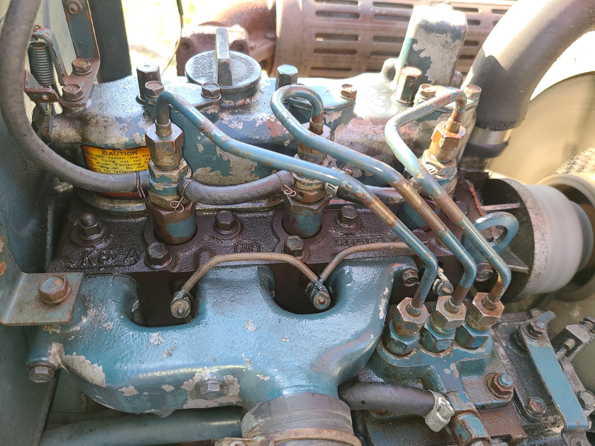

Tested the injectors.. number 2, the last one looks to have a uneven spray.. others look ok.. I did find rebuilt ones for 42 each with exchange

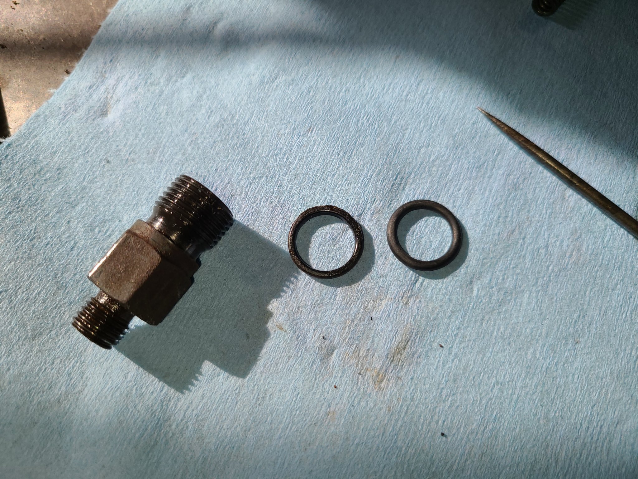

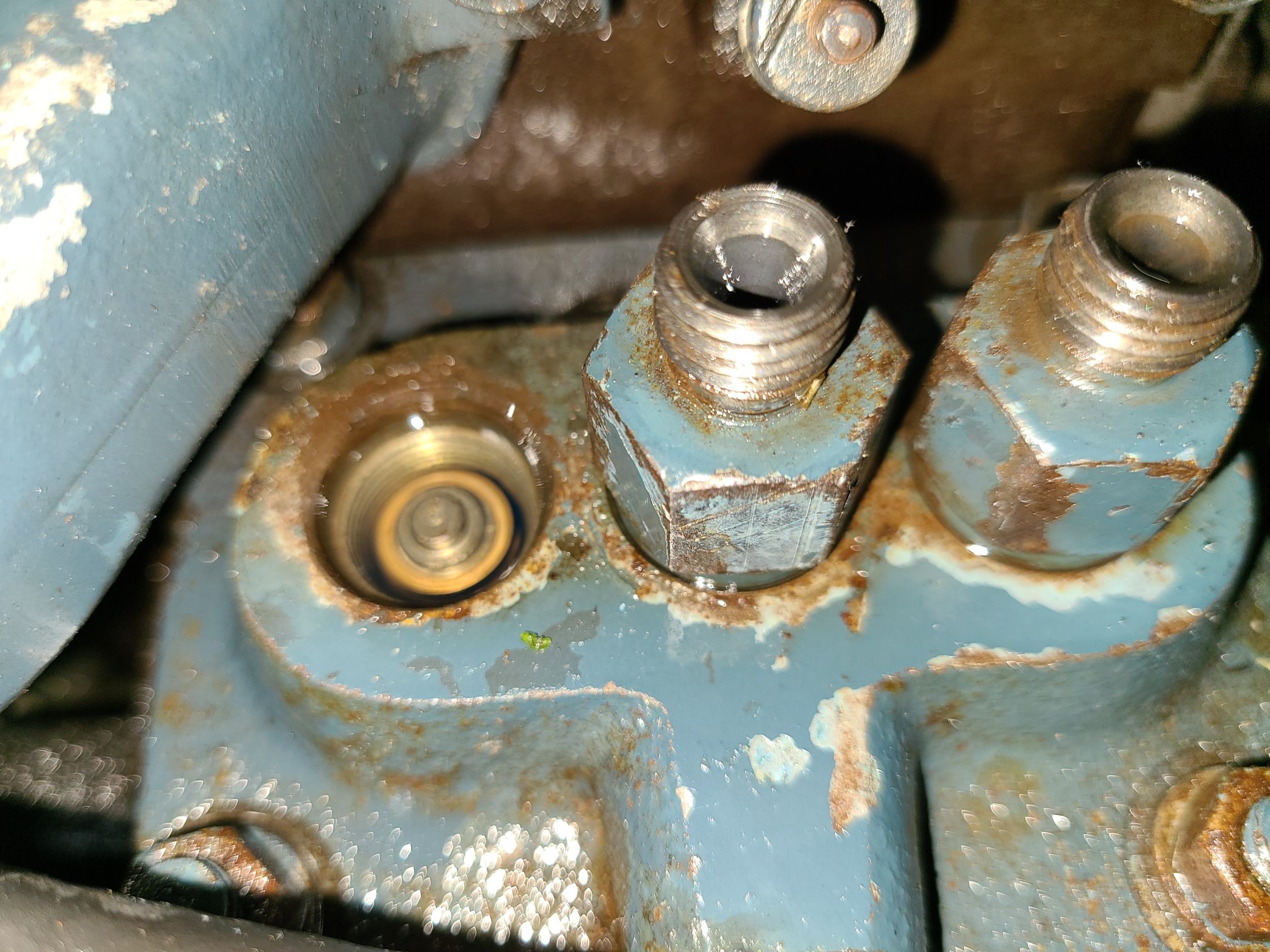

I just changed the oil and fired it up.. no more knocking..., for now... I did clean all the injector nozzles, but now the plungers are leaking at the bottom taper.. the lines were stuck on and the plungers turned first.. was a pita to get the injector lines off..
Opened a can of worms I did

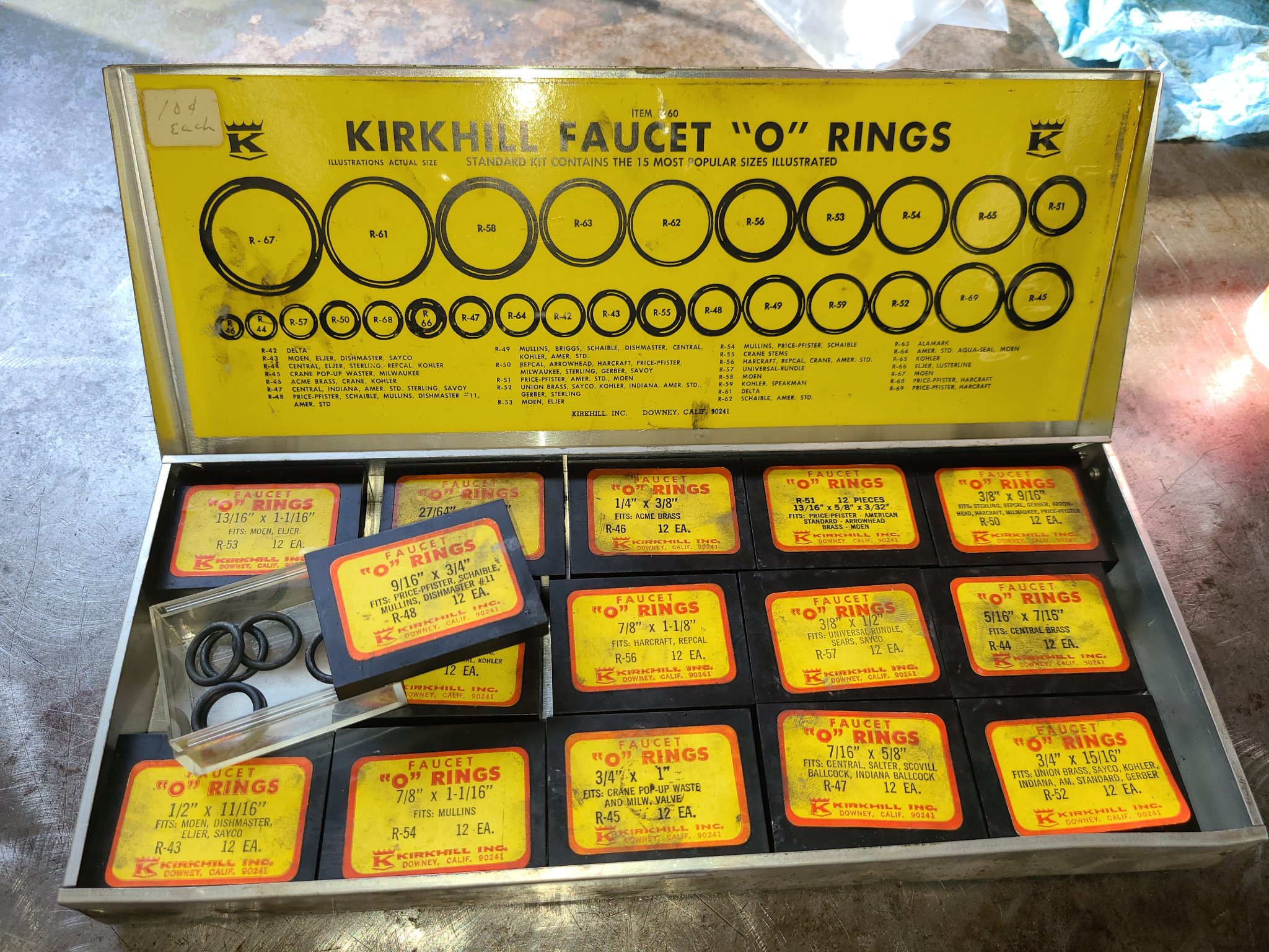

Well I fixed it.. had some old faucet rubber o rings that fit perfect.. no more leaks! Ran it for 20 min no more knocking.. and the radiator is not leaking anymore and it got up to 175 degrees at the radiator after 25 min run time.. its 82 today..
Love happy endings. May not be a bad deal for someone at that price now that it is running right...

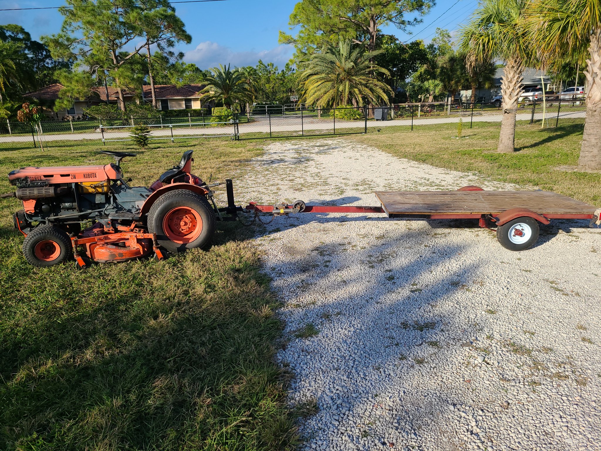

Hooked up my little trailer, decided to sell it with the tractor so maybe it will be more useful to someone when someone buys it
