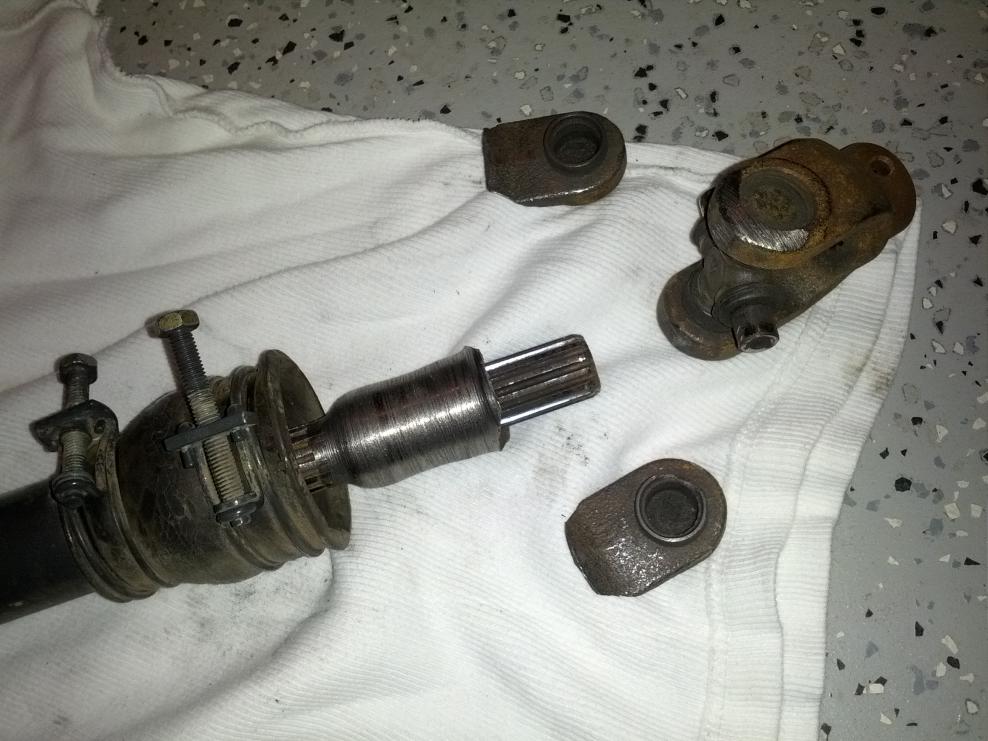

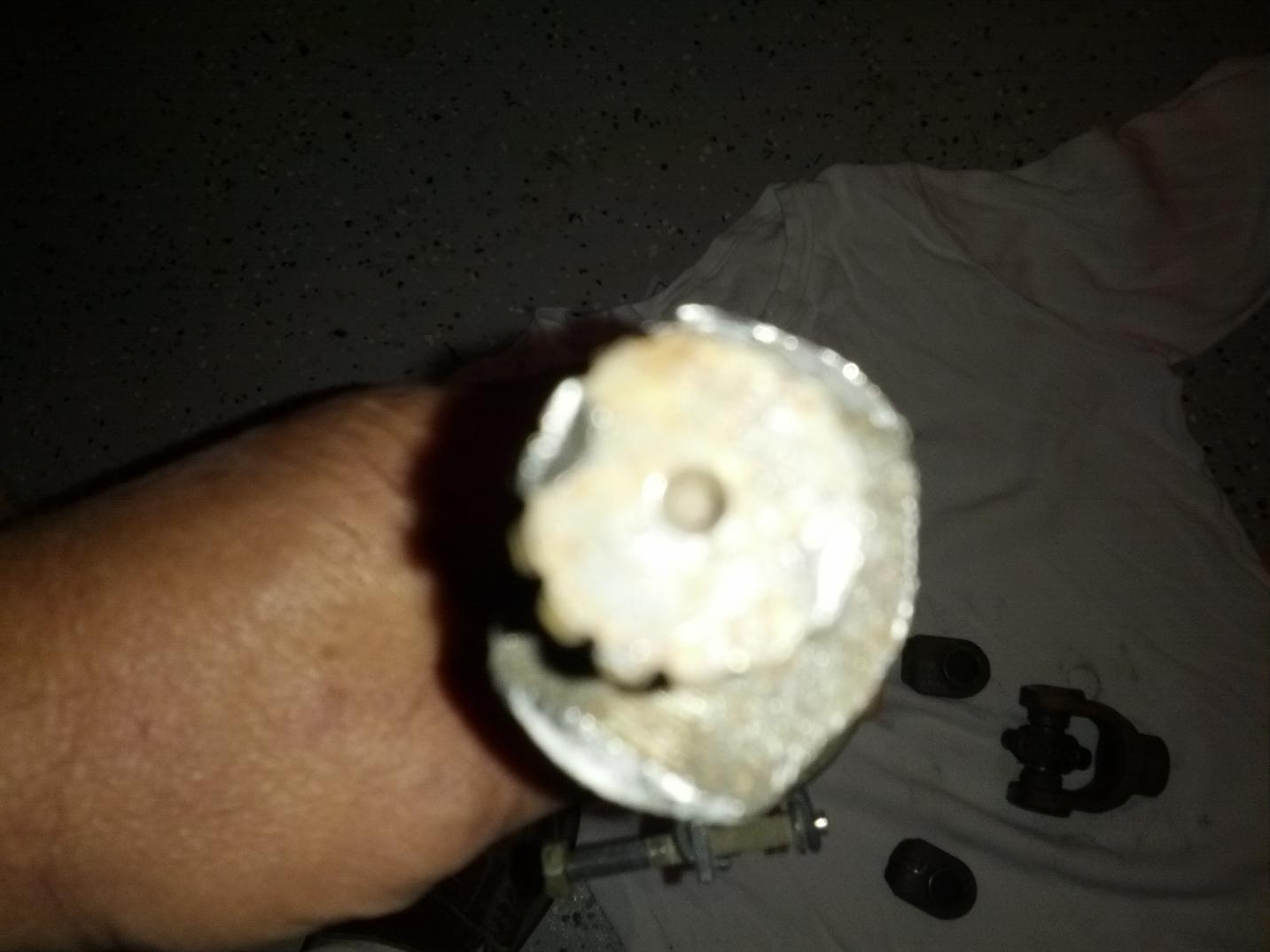

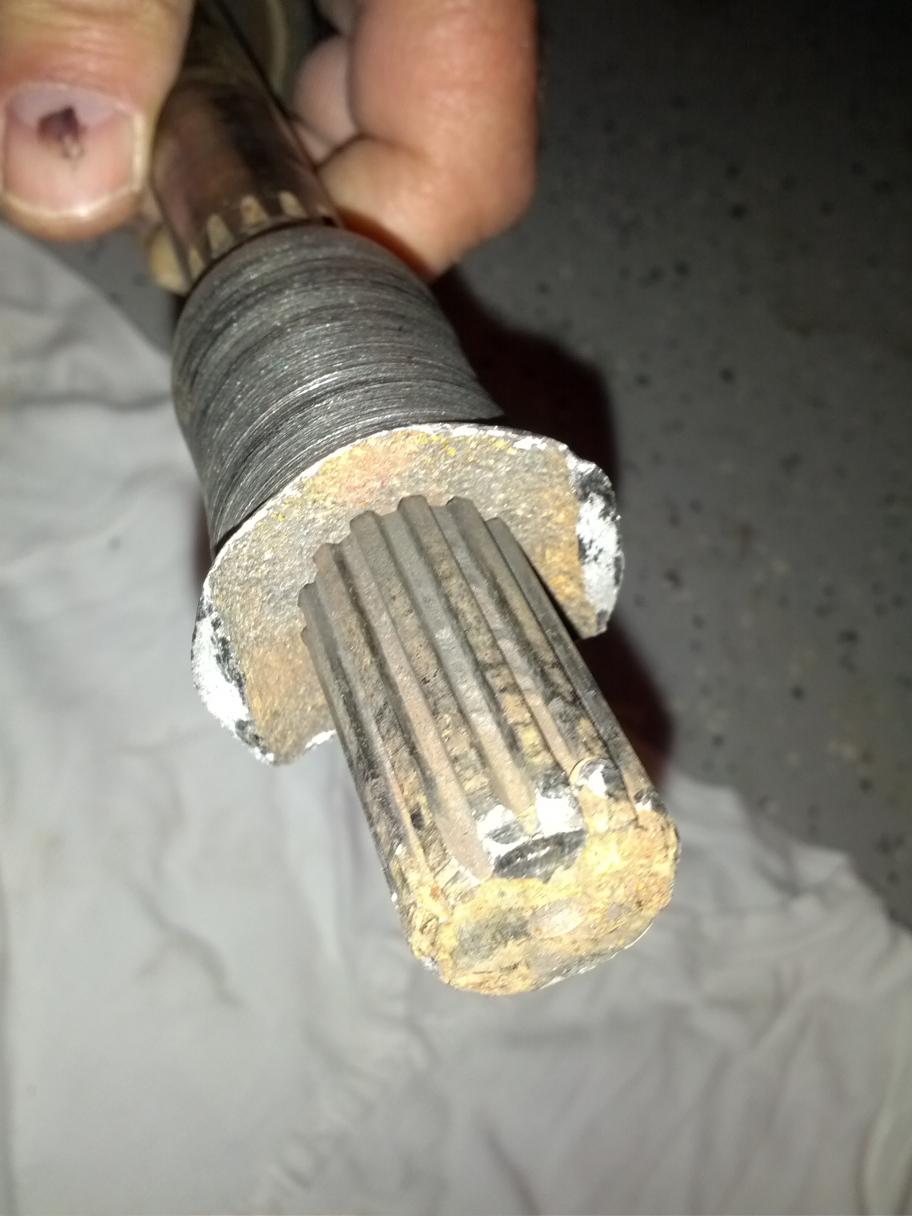

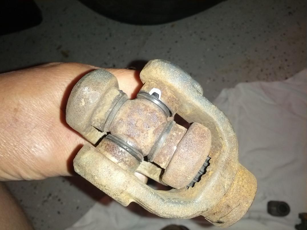

Here is a couple more. The universal joint that is whole has a lot of slop and needs replaced. Do you think a shop would carry the joint or I would need to order the parts and provide to them? The end spline has some damage where the yoke broke. Not sure if that could be repaired?
Kytim
B6000DT, B7100DT,Snowplow, RM360, Scoop, Cultivator, Carryall,Disk, plow
Aug 14, 2009
848
Western Ky
Before you pay that kind of money go to a driveline shop. You could also seek out Dump truck repair shops. They deal in PTO shafts this size and larger all the time. It's not unusual to chuck a shaft in a lathe to remove the yokes to replace them or save them to replace the shaft. Just get all the info before shelling out big bucks!

U-joints and yokes are standardized for the most part. I'm with lsmurphy, take it to a driveline shop before you buy from your dealer.

Took it drive line 1 and they were great. I did order a new yoke piece from Messick today. When that piece comes, drive line said they would rebuild the shaft with new universal joints. Thx again for the advice. I hope to be back in business for around $200.
