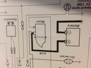

KubotaSam I think you may have hit the nail on the head. My multimeter definitely said "-12.14" when I hooked into the red wire.
I think the battery is in backward!!!!
The negative terminal on the battery is hooked to the starter/generator on the motor. My positive is hooked to what looks like a ground on the metal frame by the steering column.
Is it possible that this thing can run fine with everything but the hour meter working with the battery installed backwards?
I've attached the wiring diagram from my manual for reference.
Please let me know your thoughts. If so, this would explain why the meter worked fine when hooked to the battery but did not work with the polarities reversed.

Here is a pic of my battery in the tractor. The left side is the positive terminal of the battery-it's hooked into the frame by the steering column. The right side is the negative terminal of the battery and it hooks into the starter/generator of the motor.
If I'm reading my wiring diagram correct it's backwards. What do you guys think?
29,158
5,453
Yep backwards battery hookup. :eek:
it's possible that when you hook it up the opposite and proper direction that the regulator for charging could possibly be fried, it's about the only part on that tractor that cares about the polarity. ;)
