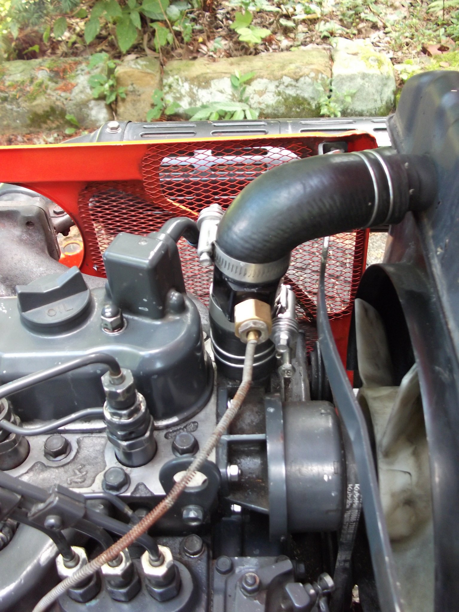

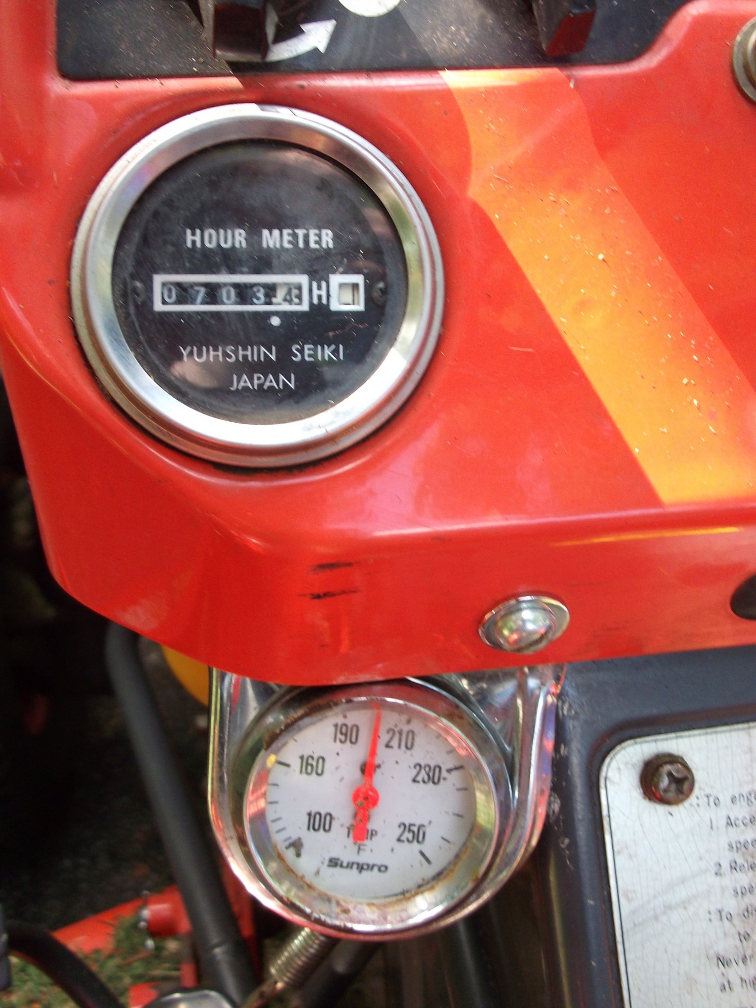

I also added a temp gauge using a 34mm [Glow-shift] adapter shown on previous posts.
The supplied clamps were pretty light so I replaced with much beefier items
But on restart, the temp climbed to 190 idling and 220 under load. = seemed WAY to high..But,
I retested the cooling system for leaks and sure enough, it held 16# for an hour. [whew]
And after a review of some other posts on the thermosyphon system, it seems that 220-225 is OK.
I mowed with it for about a 1/2 hr this AM and it topped out at 210.
