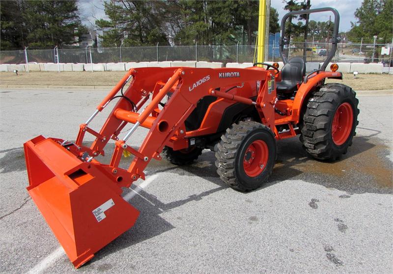

My only observation is that there's not much dump angle. With mine, the bottom of the bucket is vertical (and maybe even a little beyond) at full dump. Most of the time I'm at full dump before all of the material comes out.
7,836
3,068
That would be my only concern also. If material in the bucket was the least bit sticky, I think you might have trouble getting a full dump. Tried to find a pic of mine at full dump, but I don't have one- I'll get one when I can, but not sure when that will be.

08quadram
bx2350d; Taylor Way 48" tiller; Farm King 50" snow blower
Apr 28, 2014
289
strawberry point, ia
The loader arms on my Woods FEL attach to the bucket within an inch or so from the bottom of the bucket. Seems like that and slightly relocated dump cylinders could get more dump and possibly more overall height? But, I design buildings, not loaders.

Dave_eng
M7040, Nuffield 465
Oct 6, 2012
5,257
1,042
Williamstown Ontario Canada
For about 30 years, I had a loader bucket style like the one you are planning. It was on a bigger 2wd tractor
The frustration was that the bucket would not curl back enough to carry a full bucket of loose material such as gravel close to the ground.
I always admired the bucket mounting first found on backhoes and now on tractors which involve an intermediate lever to increase bucket movement.
I always intended to modify mine to incorporate this feature but ill health brought this dream to an end. With the original style I liked being able to tilt the bucket vertical and grade using the cutting edge of the bucket. You could see what was happening and dislodge rocks.
After becoming too ill to be doing mechanical work, I bought a new M7040 with a loader included. Its bucket has the extra lever and will curl back like a trough when you need to carry material.
The one downside is the caution from Kubota not to push with the bucket tilted down. I guess the lever which increases the range of motion of the bucket also increases forces on the system which it cannot stand up to. You are to only push with the bucket parallel to the ground and then you cannot see as the bucket is in the way of seeing the front cutting edge.
Dave M7040
