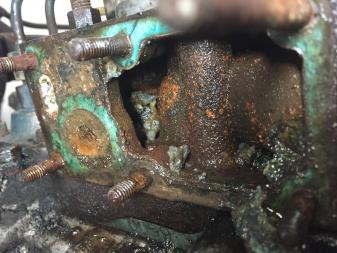

I'm still going over a 78ish B7100 that I picked up a month ago and playing catch up on fluids and the such. I honestly think it was a fuel and go machine for the past few years based on what I've seen. A slight belt tightening last night turned into failed Dynamo bearings this morning. I finally pulled the Dynamo off after a 2 hour struggle with corroded studs and was shocked to see jellyfish looking slime in the block. I read an old school technique for flushing with vinegar. Does this actually work? I hope to get to that point soon if I can find the bearings locally.

DID ya have fun getting the middle lower nut off??:D:) Putting it back on is fun too!
White vinegar works well, need to run it up hot for a while, empty, and repeat. It will be better than it is now.
As for bearings, 6201 , this is a standard bearing you can get at NAPA or any place like that.

WOW, THANK YOU! You've just saved me a ton of time on a bearing hunt! Actually, I lucked out with that lower center nut.... I think the last time it came off someone gave up on it and didn't even bother putting it back on lol. I haven't broken the dynamo down yet to look inside. Instead, I chose to break down a couple of Coronas.

The slime is silicate drop out which occurs when the coolant is not replaced when spent. Supports your statement about the previous life of the tractor.
Problem using an acid (even mild) for flushing is neutralizing what will remain in the system. With that said, I used muriatic acid (5-10% Hydrochloric acid) to clean a really corroded system. Then cleaned up with flushing 10 times with distilled water and then changed the coolant after one year. Never had any issues from that. Jeff

Thanks Hokie! A/C Delco wanted $49.00 per bearing (they're close) and O'Reilly's saved the day at $1.99 each with one in stock, and one set up for a store transfer. Once I got the case opened the bearings were intact, but frozen solid. A hydraulic press is a must for pressing them out and in. Thanks again for your help!
