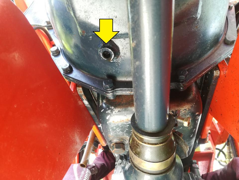

I recently overheated my B7001D (I had not noticed the radiator getting clogged with seed heads etc) and the lower radiator pipe split, I shut the engine down straight away. After a quick in-field repair I got the tractor back and parked up and replaced the rad pipes. I later noticed there was a pinkish liquid leaking, it was dripping from around the bottom of the front axle, but it wasn't coming from there. It isn't engine oil (that is pretty dark and dipstick shows okay) it doesn't appear to be hydraulic oil, again, dipstick shows tank is full, it isn't radiator fluid, wrong colour.
I did wonder if it was a diesel leak, the colour is similar. So I cleaned up the entire engine applied some talc powder around a few parts of the engine to try and trace the leak. No clear leak from the fuel system, or anywhere around the engine bay really...
Then I found what looks like a drain point under where I think the clutch is. There is no plug in it, but it is a threaded hole.
I'm not sure how the leak would get from here to where it was dripping on the axle, but stranger things have happened.
I have uploaded a picture, I took it from under the tractor looking forward, you can see the drive shaft for the front wheels. Can anybody tell me if it is a drain point, and if it is, where do I fill this area from, and what grade oil?! I cannot find it in the manual (I'm using a B7100 manual).

Olive Farmer, the plug you have in question is a drain plug. In Kubota's early days their tractors were primarily used in Japan in rice paddies. When water got in the clutch housing it was released there. Not much in there to leak unless a rear seal is bad, and I think there may be a freeze plug up high. I'd drain it and keep and eye on all fluids and eng. temp.
Sometimes, on various equipment, you may see a hole with a cotter pin loosely hanging out. Those are also drain holes, and the cotter pin helps keep dirt and mud dobbers from making residence there and by constantly being jiggled around keep the drain open!
33,466
8,745
Yep, what D2Cat said, no fluid should be in there, and if it is something is leaking, it's not going to hurt anything if you leave the plug out. ;)

That cotter pin trick is good, you answered a question I didn't even know I had. When I changed the radiator pipes there was what looked like a corroded washer in the bottom inlet of the engine, I bet it was for that purpose. It is just the sort of cavity that could get clogged up. I took it out! Looks like I'd better drain down and put one back in...

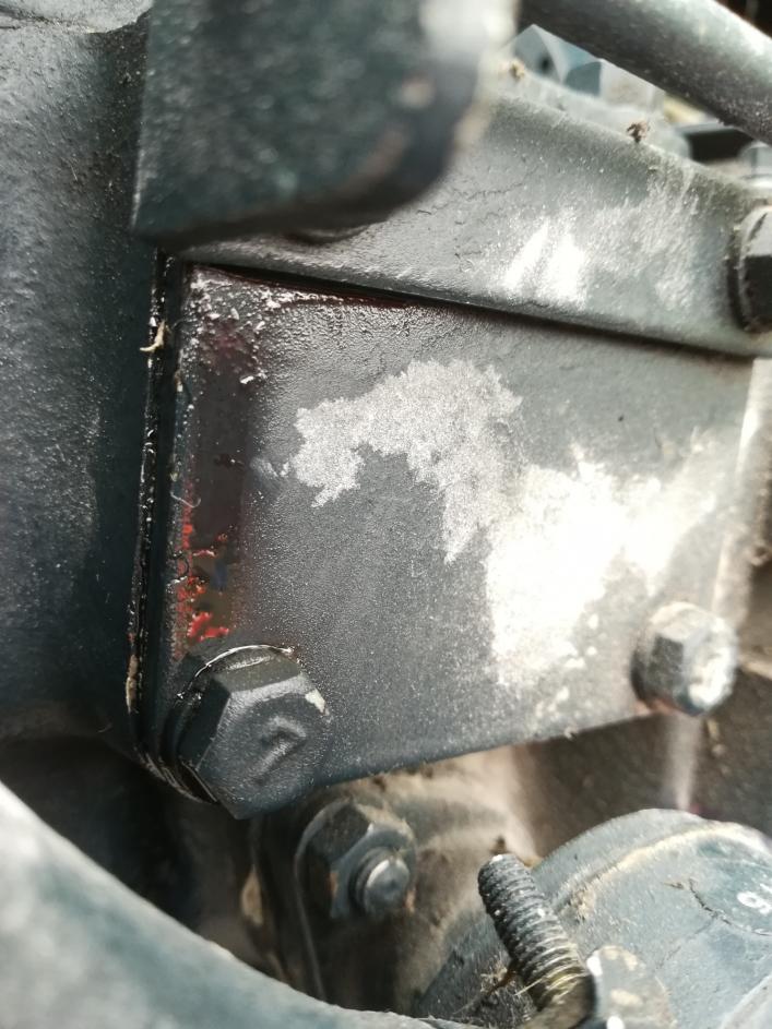

I also traced the fuel leak back to the source thanks to a bit of talc. Can I pick your brain again please. I have attached a photo. It is coming from a bolted plate under the accelerator arm. The bolts were not very tight as I was able to give them a quarter turn very easily but didn't want to go further without looking into it a bit more. I'm assuming this is an access plate, I have not found it in the manual.
Thanks!
