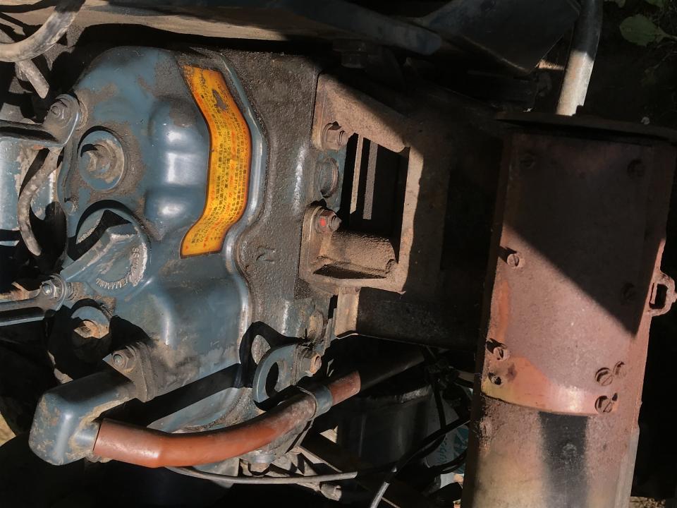

Kubota B7000 Cub Cadet 1782 Cub Cadet 78D York Three point rake Woods RM 400 mo
pretty darn close to it. The only difference I can see is the breather bolts to the box.
Got a good shot of the prev owners muffler repair
Not that I blame him that thing is expensive.
Will leave you know ordered b4200 4wd
15261-14520 gasket
15521-05670 breather filter

Sorry to hear it didn't fit.
Sounds like there isn't any other engine like that one. :(
