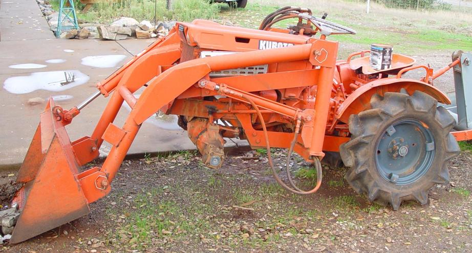

Hi, again I am posting for help finding any info on this tractor. I am trying to get some better pics up now. The unit has no markings on it that I can tell. I am under the impression that it is a mid 1970's kubota b-7000. It is a 2cyl., 4wd-w-high/low range, pto, front loader, rear scraper(which is the only thing that is not kubota red). I am in need of front u-joints and yoke assembly.Please help if you can can. Any and all information would be greatly appreciated.Thanks .....Dave.....

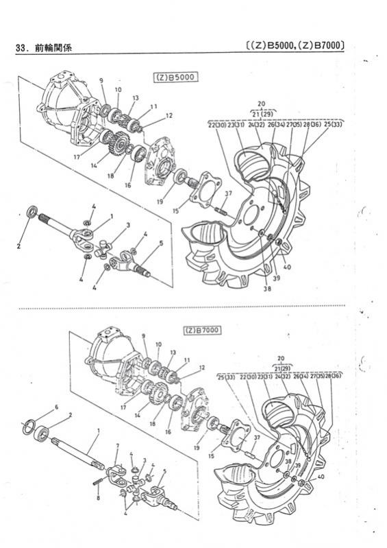

That does look like a B7000 I have one as well. I've attached two pages out of the parts manual that show what you need I think. With those part #s you should be able to get the parts from a kubota dealer. Good luck!

Don't suppose you have a copy of those pictures that is a little larger? I've tried to enlarge, adjust contrast etc but still can't quite read the part numbers. Thanks for your help.

Why don't you pm me and I'll see if I can email bigger pics of those part sheets.
